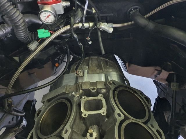

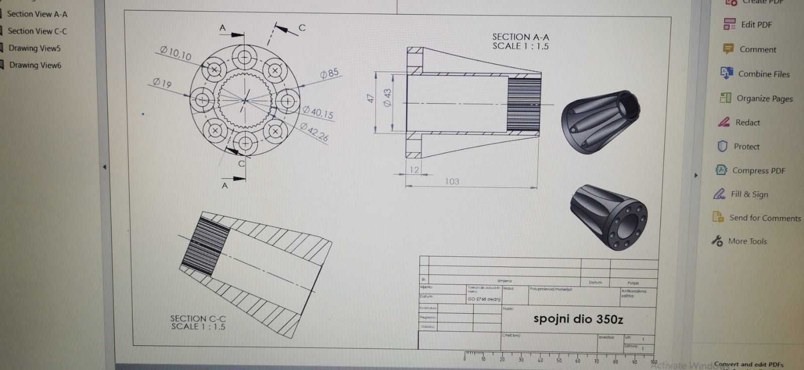

Last two months of development on DKG conversion. From 3d modeling to production.
Mechanically need to fabricate connection joint on the driveshaft and it is ready to go. It will be controlled with HTG GCU ( standalone Gearbox Control Unit) which will communicate to the Haltech ECU via CAN bus. BMW M4 shifter will be used both with some steering wheel shifter pads.

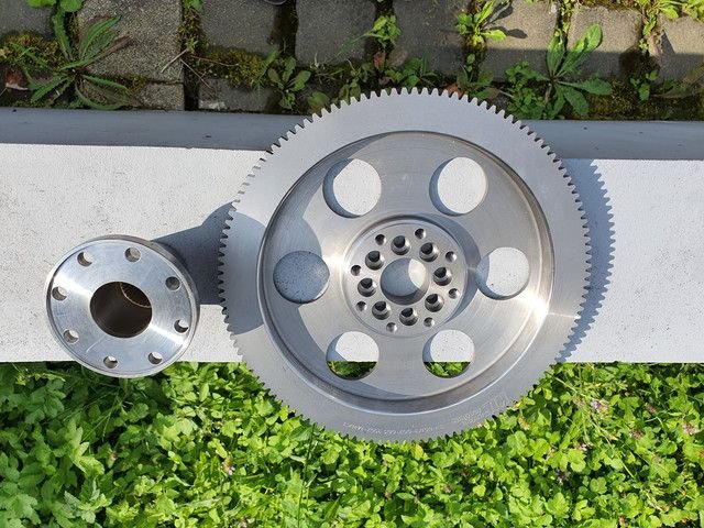

Adapter plate, pricing is in a ball park, but you need a new flywheel and flywheel to input shaft adapter too. You could probably modify aftermarket 350Z flywheel (like JWT) and still need FW to input shaft adapter. Also, do not forget driveshaft, you might need a custom made one too. I still believe that OEM carbon can be used. Oh well, soon we will know for sure, probably in a next week or two.
