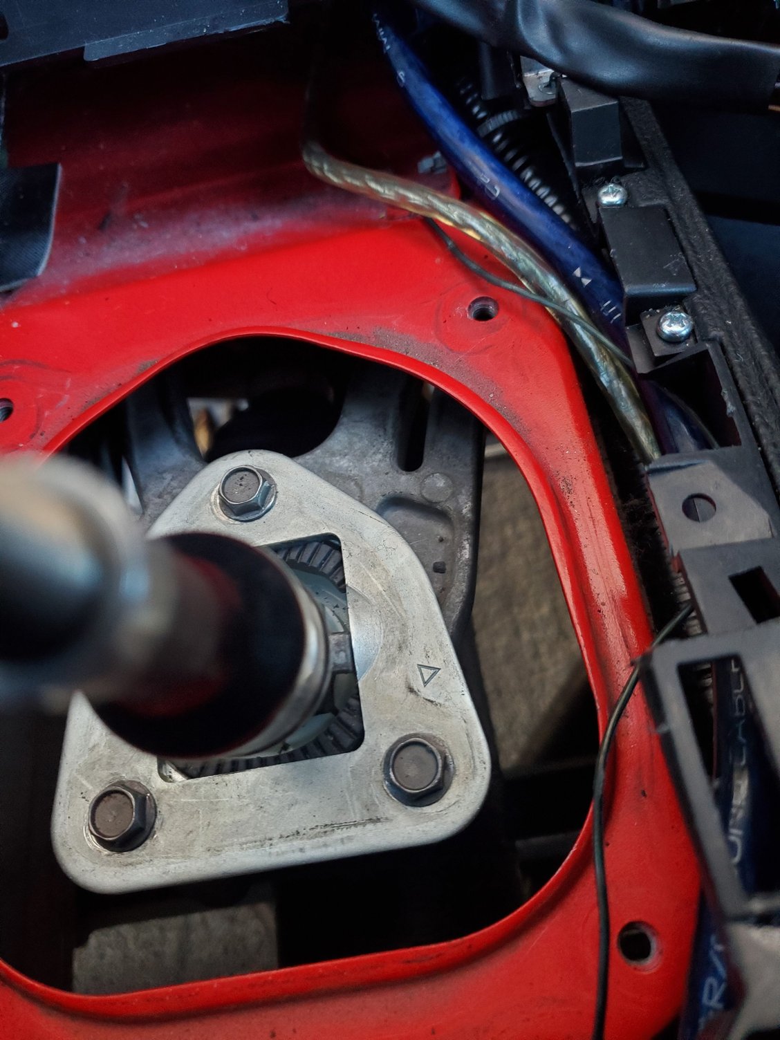

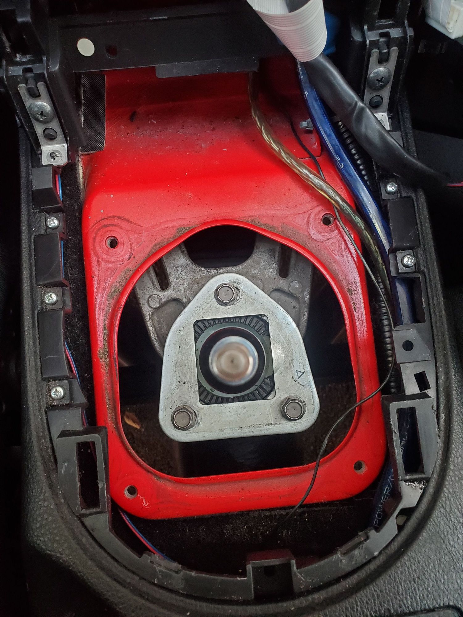

Here's a picture of my shifter plate when I got it back. You can clearly see it it wasn't aligned right.
Here's a picture of it after I made adjustments
When I got my car back and drove it back home, going into 5th gear felt weird as hell. It was almost like I had to move the shifter over to 3rd gear to go into 5th gear. That's how I knew my shifter plate was off.
I haven't changed out the shift linkage, been on the car since factory. So I can try and do that and see what happens before dropping the transmission again.

Double check your shift plate adjustment again to be safe. I assume you're following the FSM procedure where you shift between 5th and reverse?

Yeah I actually have a 07 service manual and I went by the directions there when adjusting my plate. I've done it at least 3 times with a friend and nothing. I did noticed when we had it up in the air and put it in R, when my friend let off the clutch the rear wheel spinned and then popped out of gear. I thought that was weird. I will check it again when I have some time.

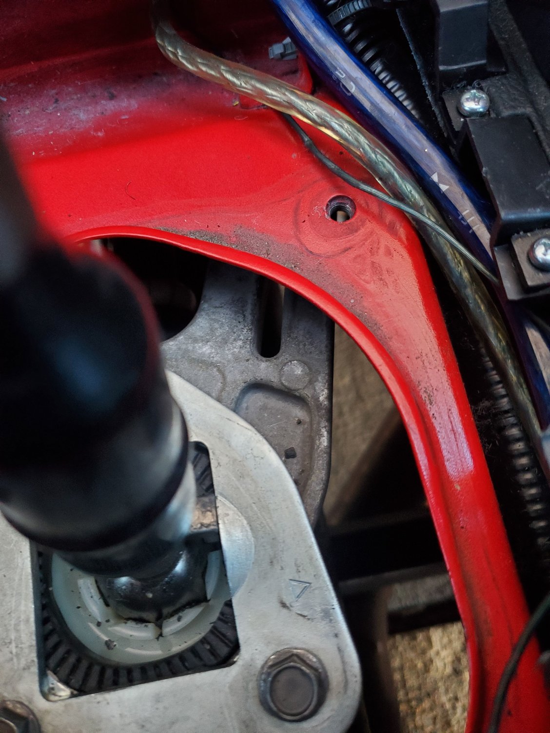

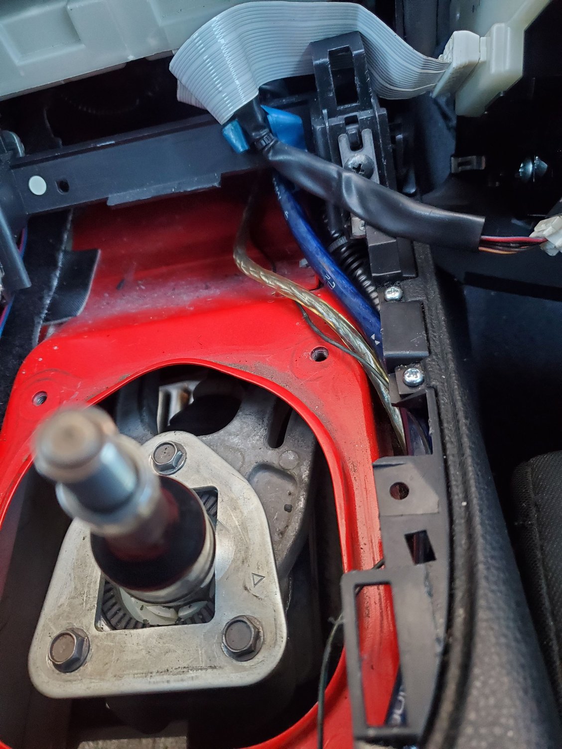

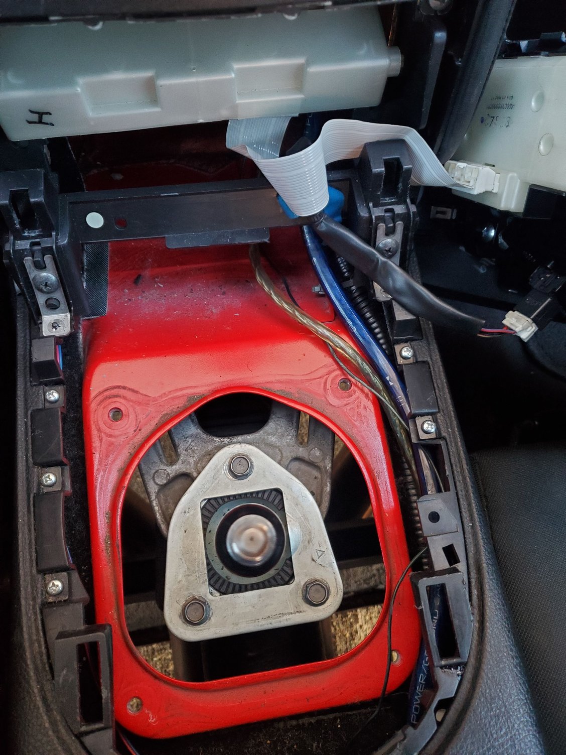

Here's 3 pictures of it in 5th, 6th, and R.

I mean the detent *****/springs inside the transmission.
Only other thing I can think of is to check the linkage bolt from the shift stick to the transmission. It's hiding behind a rubber boot under the shifter assembly (accessed from under the car).
The shop would have disconnected this during the clutch job, so perhaps something they did wrong there? Bolt could be loose? Another poster on here said theirs fell out or nearly fell out while driving.
