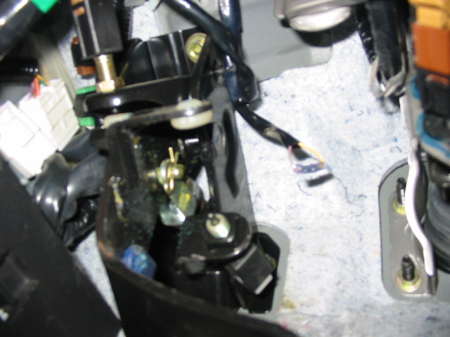

here is a pic of the pedal stop installed...

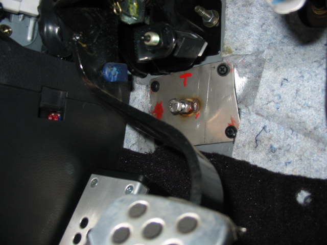

here it is with the clutch pressed in hitting it... see how far it is from the sensor that will let you start the car...

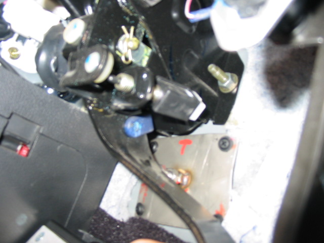

we disable the switch that you have to hit to start the car...
i can start my car without pressing the clutch...
just make sure you are not in gear!!!!!!!!!!!!

if the pedal stop was not there the the clutch pedal would go all the way to the floor and it would wear out the pressure plate and burn up the clutch...
after the pedal stop is installed the pedal wont go down far enough to hit the sensor so the car wont start when you press down the clutch...
i think this is the "problem" with the trans in our car... when you press the clutch all the way to the floor it is hard to shift into gear... but when you press the clutch half way down it goes into gear easly...

its a liabliity thing we have to let people know about other wize we dont want to get sued for people starting their cars in gear and it shooting forward...
ever start the z in gear with the e-brake down pressing the sensor... you shoot forward...

no need because you can press the clutch pedal all the way to the floor to start the car with the stock set up...
although... i do not think you should press the clutch all the way to the floor with the stock set up... i think that is what is starting all the tranny problems...

Jason, do you sell the clutch stop independently from the Tilton clutch. It also appears that with a few washers etc, that the switch contact poitn could be "raised" to allow the switch to be depressed even with the stop is installed.
Old Jul 22, 2004 | 04:42 PM
  #40
Jason@Performance's Avatar
Jason@Performance
Performance Nissan
Joined: Oct 2003
Posts: 8,783
From: So-Cal - Ready to go?
yes I do sell them seperatly... it is something we fabricate and each one needs slight modification (bending) depending on the car...
there is some adjustablity in the sensor... but, I prefer not having to step on the clutch
