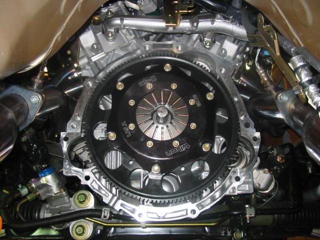

Yeah, it depends on what you want. Stock flywheel weighs close to 30 lbs. I started with the JWT 14 lb. aluminum flywheel and stock clutch. It is good, but not great. Had some stalling problems, but still very streetable.
Then I switched to Tilton 8 lb. Flywheel & Rally Clutch. It is great, but difficult to drive on the street. Very hard to launch from a dead stop. Once you are rolling, it is fine. You need to be aware of the streetability issue before going with Tilton. I have gotten good at launching mine, but even I kill it now and then. Revs like a banshee. I love it.

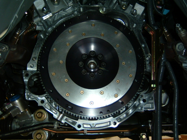

nice pix!!
((see the f/s section, my JWT is listed!!))

esemes, so you paid the labor to put it on and then take it off? Yikes! I guess I don't hear the noise people are talking about frequently enough (maybe once a day at most) w/ my JWT setup for it to bother me.
