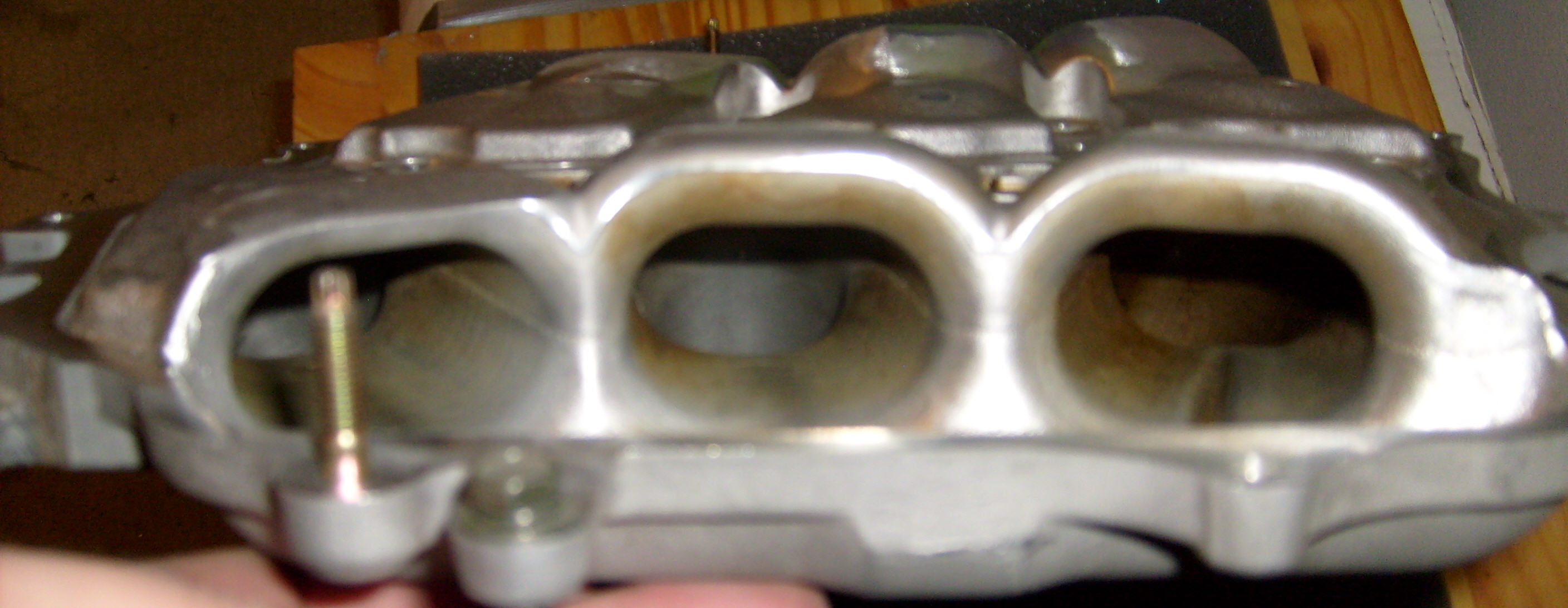

Just finished doing mine. Only took off the casting marks on the back 4, and heavily shaved the front two. Thickness of the top was 1.85" and I took it down to 1.5". This was just using a set of calipers, nothing like a good set of micrometers or a CMM lol.
This took about 90 minutes to do with a $45 electric angle grinder and 60 or 80-grit "flapper" sanding disc (Can't remember which). I could have went up to a smoother one and got fancy with a dremel, but I'm convinced that the distance is the biggest factor because the MREV looks like it hasn't been blended at all. I did some blending, I probably left the top of the air horns too knife-edged, but oh well.
Top:
Left:
Right:
A little bit much blow by for 70k miles, so I'll probably put a catch can in next weekend.
No Dyno numbers, nor do I plan to. It seems to be faster, but I'd call it the placebo effect. Still, it cost me nothing and who knows, might have gained me a few hp.
