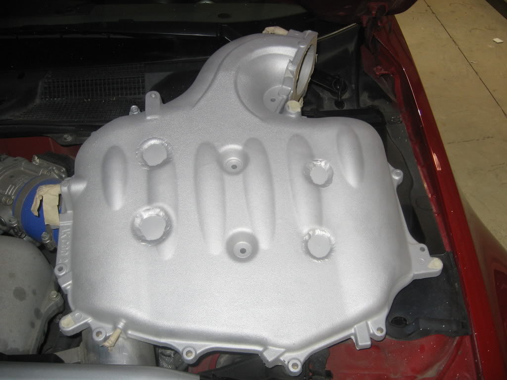

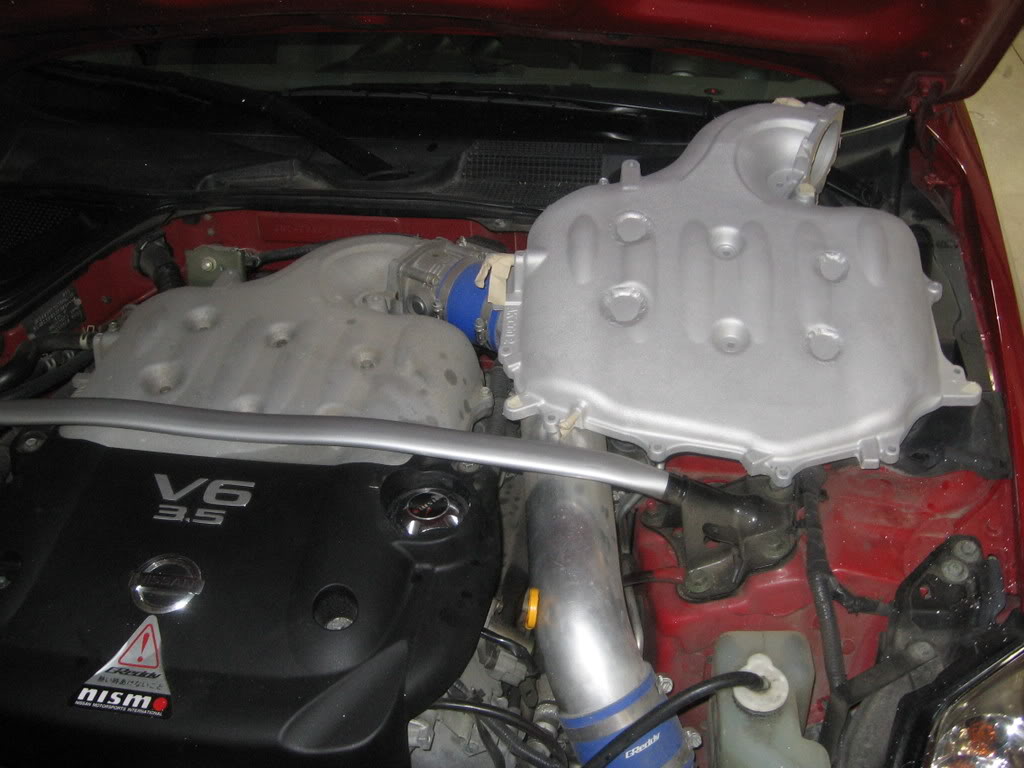

well i haven't made much progress on my plenum working mainly due to time and not have the spare cash laying around to buy a couple of lowers but i had some free time so i finished sand blasting on my upper. not sure if i'm going to paint it or powder coat it or what though yet. i'm also working on an idea i recently had about some intake work for greddy tt kits to get rid of the mushrooms of death and keep heat away from the filters. but here is a couple pics of my upper.

what did the sand blasting actually do? Did it make the exterior more gritty? What was the purpose of doing this? Looks nice and clean though...
mainly it was to take away the smoothness of the metal that i welded into it and overall cleaned the entire plenum without taking away the grittyness. if you look at it really closely it actually added a little more fine grit to the grit that was already already there. it looks alot more smooth in the pics than it really is

A sand blast surface paints and powdercoats very nicely and has the best possible adheason.
yeah i'm not sure which i'm going to do yet or even what color i would go with if i do paint or powdercoat it, i have this powder that makes things look polished, its call almost chrome. its the lazy mans way of polishing something and i might go with that. i'd leave it how it is now if i knew it would stay so nice looking, i could powdercoat it with clear but that yellows over time so i'm not sure, there are so many options heh.

Anodize would be trick.
I can't recall ever seeing that.
