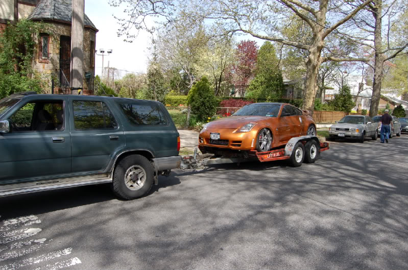

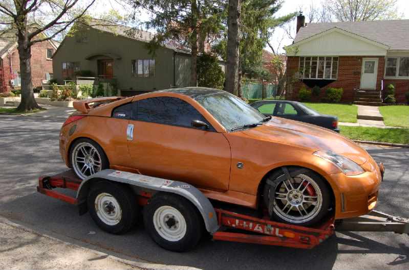

Here is how I brought it to the tuner:
Kind of makes you feel like its a race car when you see it on a flatbed.
Anyway, we'll see how it works out.
