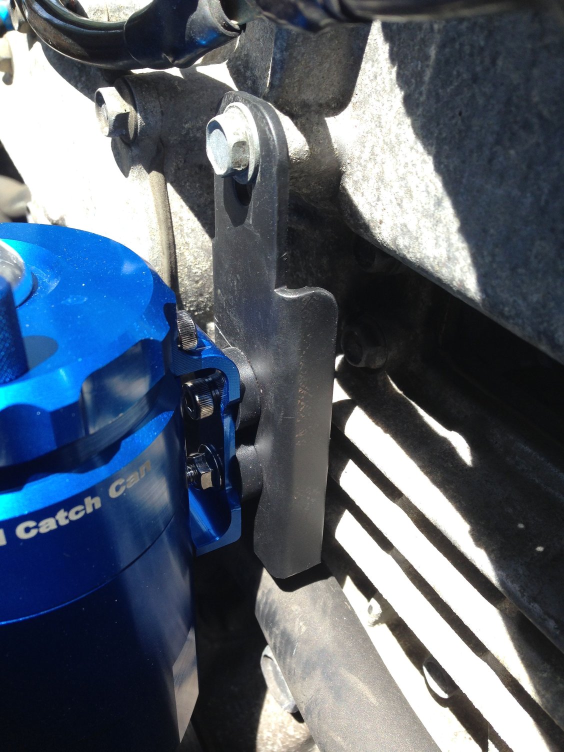

As you all know, the vq35de motors are notoriously known for oil consumption coming from the passenger side valve cover, which go back into the lower plenum. I got the catch can off of EBAY for about $100. No need for a $250-$300 Mishimoto or some other name brand catch can. As long as it is baffled, you're good to go in my opinion. Here's a few pics of my Oil Catch can install, and I must say, it is working very well. After putting only 200 miles or so on the car, there is already a little pool of oil inside the can. So it is definitely working! Less oil being fed back into the motor ultimately leads to a cleaner engine and a better air/fuel mix for combustion, which I think means, more efficiency and slightly better performance. Only thing I had to do was create my own mounting bracket, which really was not difficult at all. I merely cut a piece of metal that I found lying around and drilled one or two more holes in it. Had to run to the parts store to pick up some 3/8" pcv hose too.
ADD W1 Catch Can (vvv) Comes with breather filter, necessary hardware, hose (Didn't even use), and 2 smaller and 2 larger fittings.
http://www.ebay.com/sch/i.html?_from...h+can&_sacat=0
Blue Anodized Oil Catch Can
My Modified Bracket
After install
***ALSO*** The Catch Can does come with a breather filter. that screws on top of the can. I was not able to use the filter because it creates a huge vacuum leak, which will cause the car to have a very rough idle. So I just used the drain plug it came with and everything works just fine. Eventually, I will also splice the driver side hose, which runs from the driver side valve cover to my intake tube as well.
