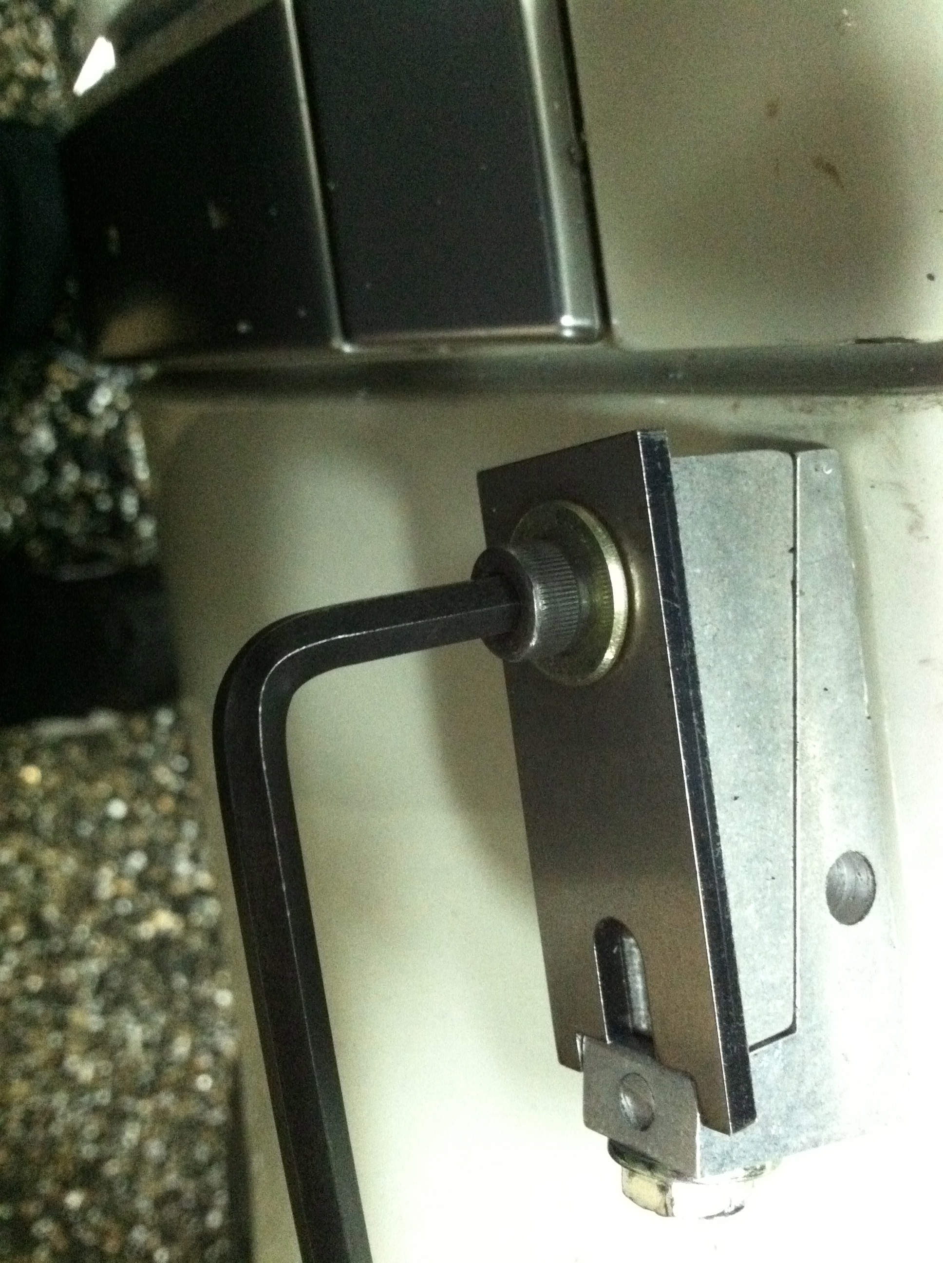

Okay finally got to installing my Rivet nuts, but first lets talk beer...
So I have not been drinking beer a lot lately, trying to cut back.. don't need that beer gut.. With that being said, I had to show case this local TX beer brewery.. Thirsty Planet Brewery, Now I just went there on a beer tour and had a blast. My favorite beer out of the bunch had to be their Smokey Porter. This was absolutely mind blowing. Every season they choose a locate TX BBQ spot for the Smokey Porter and the beers contained malts smoked by them.. The beer it self smelled like a BBQ joint. I just feel in Love with this beer.
lets start with the rivet nuts them self. I decided to do 6mm Steel Rivets. Wanted the Steel so they don't strip on me.
Here is the tool I am using to install them. And before everyone ask why not use the other hand tool like a rivetgun. Well I do have that tool too but it is in standard sizes and would be a ***** to install steel rivetnuts.
I already mocked up the fenders with your normal rivets so the holes were there, but need to be bigger to install the rivet nuts. Nothing a drill can't solve
Picked up a socket to drill bit adapter so I can use my drill to install them.. Used a 11mm socket
Getting ready to install the rivet nut. You are going to hold down the tool cause its going to want to twist on you if you don't
This is what it looks like once you have completed the install.
All you have to do is unscrew the 6mm from the rivet not add.....
BAM!!! we got a nice little rivet nut..
After I installed all 24 rivet nuts, 12 on each side. I mounted the over fenders.
The other side
At the moment I am using these temp allen bolts to make sure everything is good.. Later I will install these:
NEO Chrome bolts.. should look pretty good..
