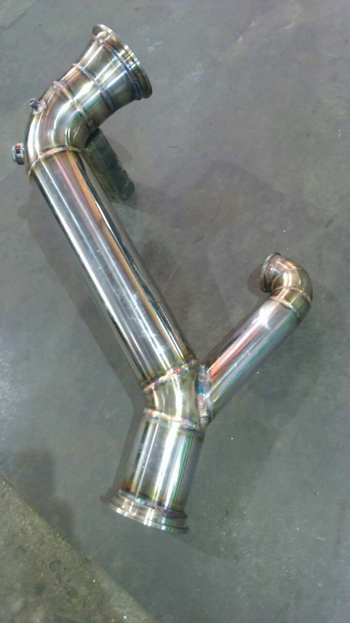

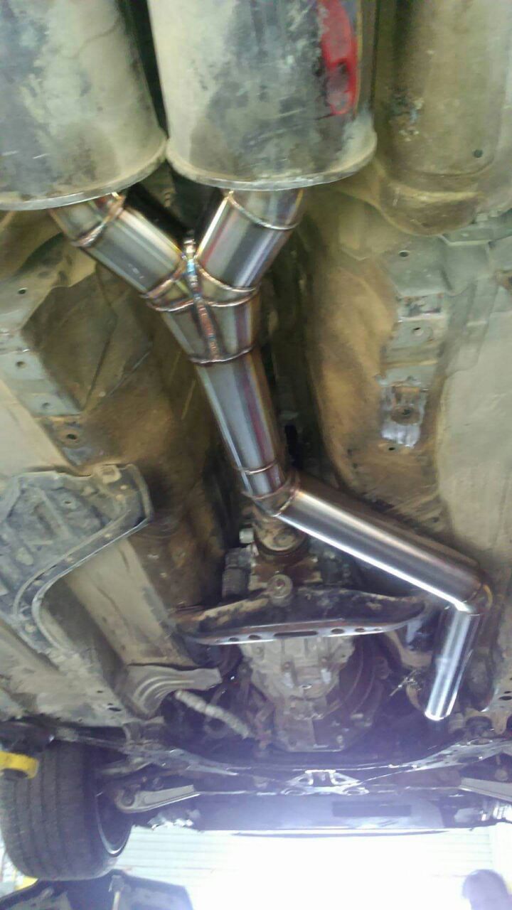

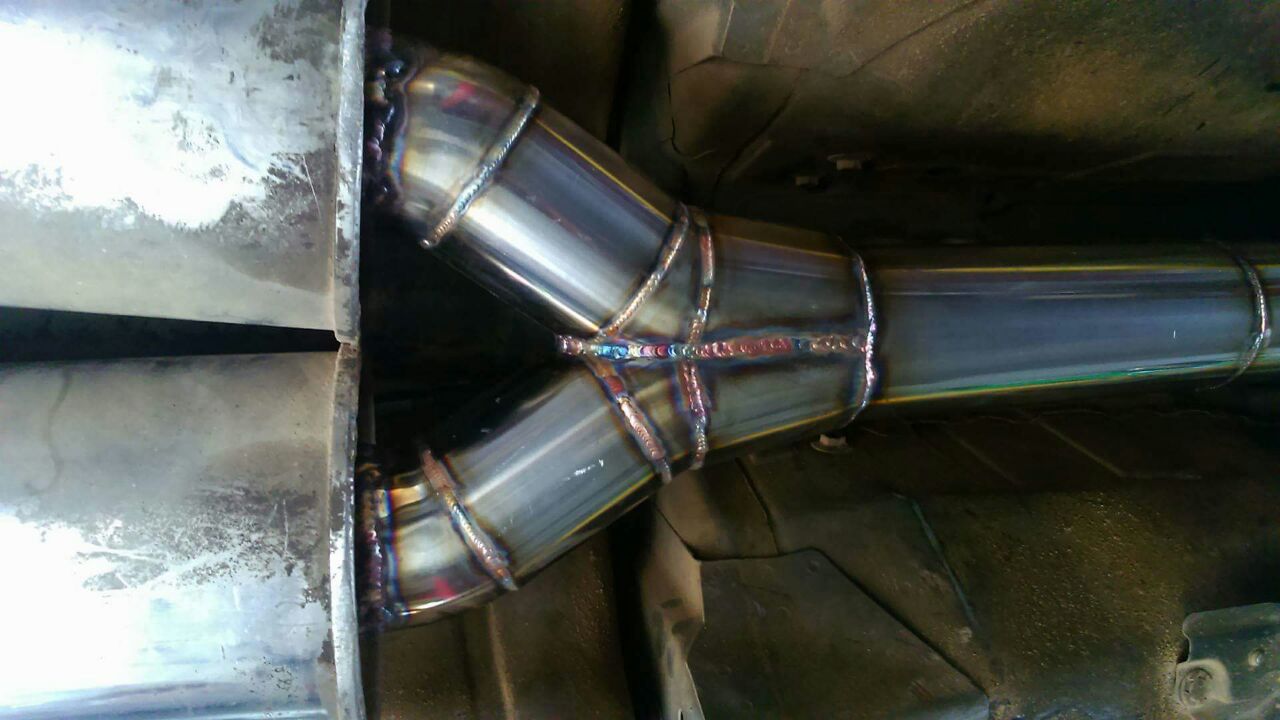

I know I haven't updated this for awhile, but I'm working on fixing the small stuff.
Trying to figure out a way to wire the AC. The Z ECU uses a lot of sensors signals before sending the compressor ON signal. Might use an external sensor to cycle the compressor on and off.
Custom made downpipe and midpipe. I know, the bottom of the car is soo dirty
And a pic of my new Q50s. I love this car

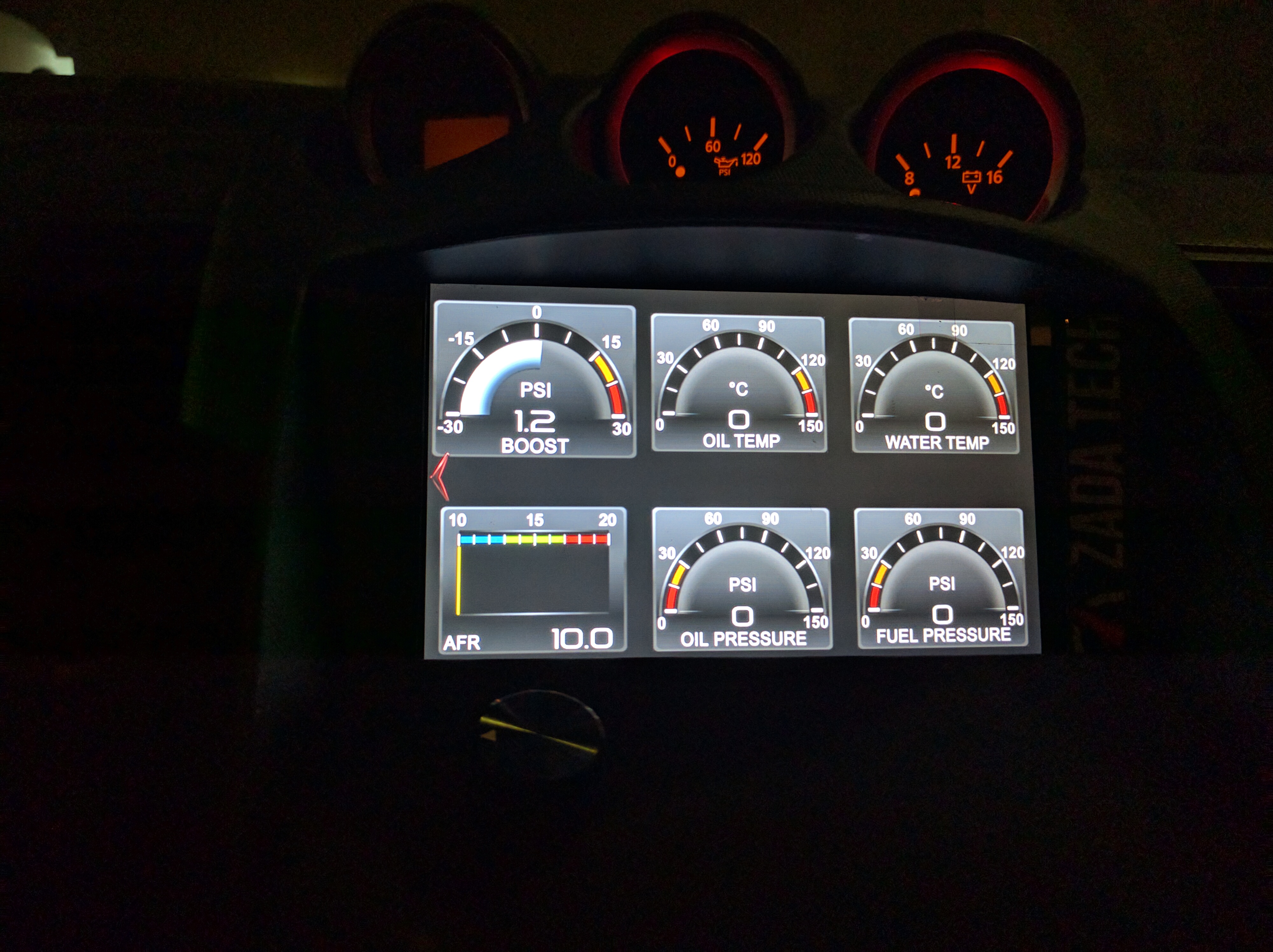

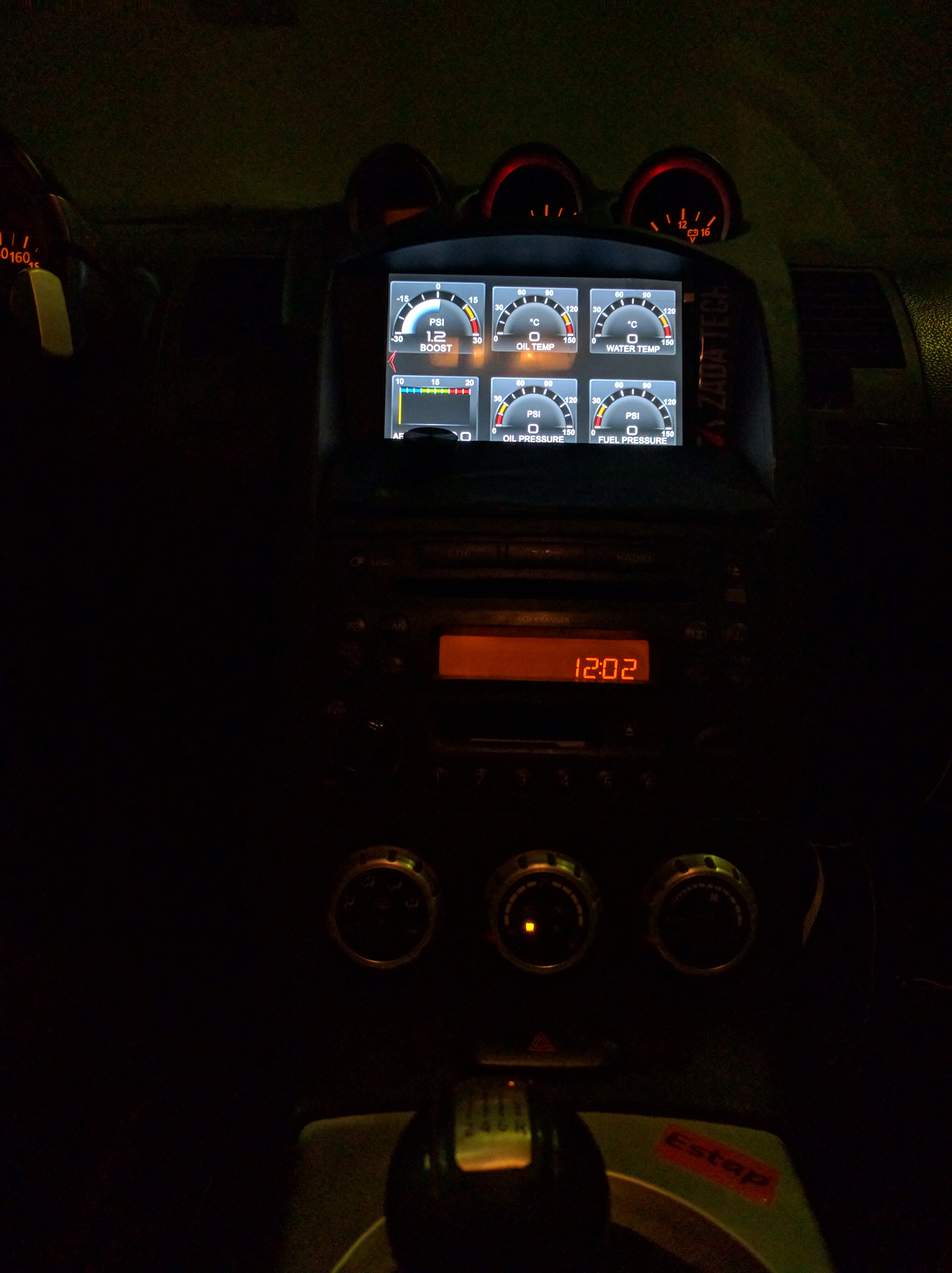

A sneak peak at the new multi gauge screen.

It's a ZadaTech multi gauge screen http://zada-tech.com/products/multi-...cd-multi-gauge

If you have the VQ then just get the OBDII version OBDII version + boost sensor and AFR support . It will take the rest of the readings from the ECU.
Also this kit can utilize the OEM screen if you have NAV.
