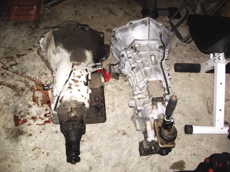

The 4L60 and 4L65 are the same length as the T56, but the crossmember mounting point is around 3" closer to the motor.
If you go on the Sikky web site they say their Drive shaft works for the 4L60.
The 4L80 is bigger and longer.
I've been thinking about putting a ls2/4L65e combo out of a GTO in mine, but with the weak Canadian dollar, it would cost me a lot.

Length is the same, width is not. They require floor "massaging" to fit it most cars that weren't designed for them.

Here is a pic of the 2 trannys side by side.
Sikky says there headers work with the 4L60, so width there shouldn't be an issue there. Maybe the pan may cause some issues.

On the T56, where the gearbox bolts to the bellhousing, it's tapered in there. The 4L60E bows outward, making it much wider there. That's the spot where I've seen floorpan contact. It's not a huge issue if you're willing to "clearance" the floor a bit with a BFH.
