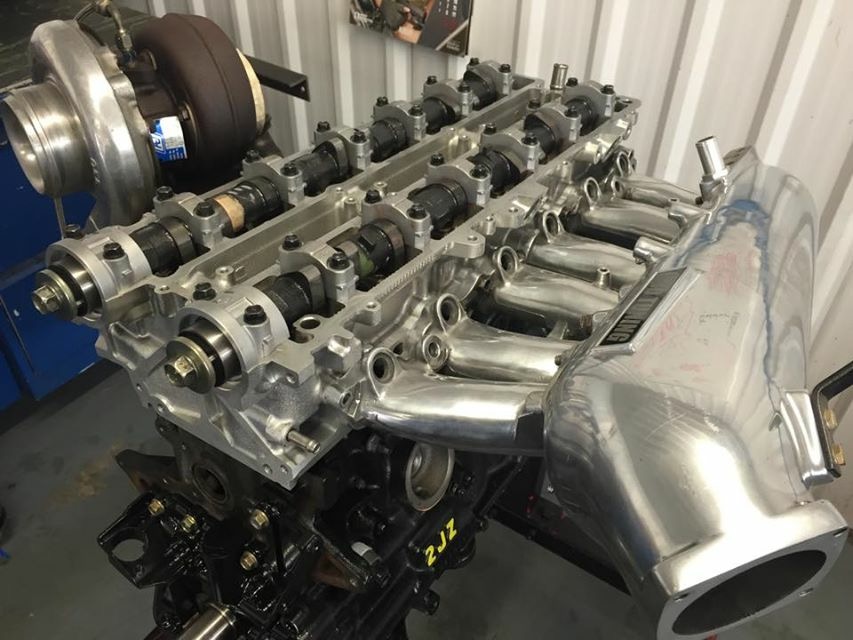

Old May 12, 2015 | 07:04 AM
IanP's Avatar
IanP
Posts: 426
From: UK
More updates :O
Hopefully the engine and box will be sat in the engine bay by the end of the week
