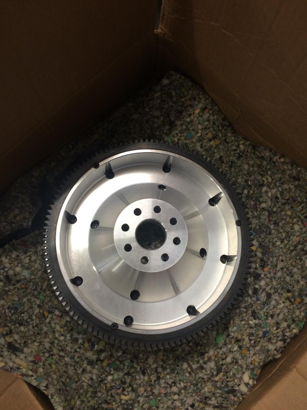

We are using the 350Z gearbox with the 2JZ engine so bought an adaptor plate & billet flywheel
