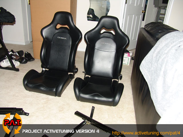

Cobra Misano "L" Can't wait to get these in the Z!

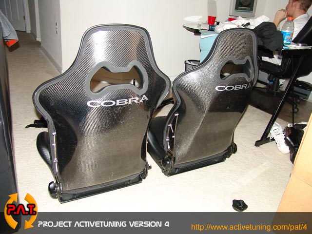

Back

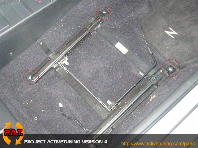

syf0n, here's some pictures of everything for the brackets:
Here's the holes lined up:

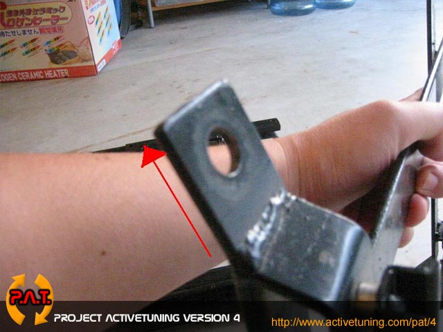

Here's a shot of the mounting points, they had to be bent about 10 degrees

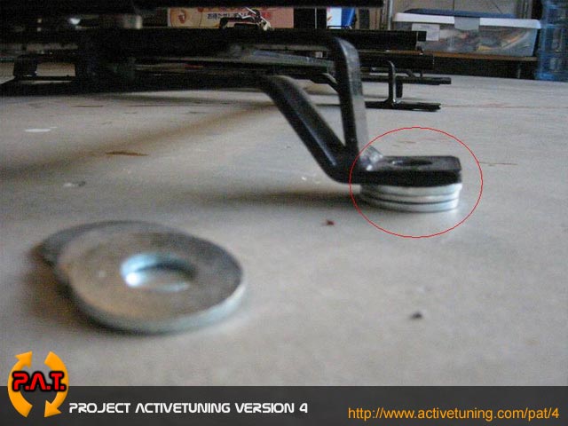

And also 3 washers needed to be added to door side of each seat (front and back)....we will be making new spacers.

Ya the brackets do suck.
The way the seat sit of them dented up my door panels pretty good.
Me and Elitemotion were the first to have the seats and used washers to tilt the seat.
This helped up to celar the seat from hitting the door panels.
