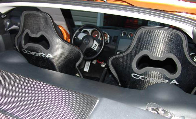

Here's the pics of the seats in my car. The fitment was actually good, except the drivers side hits the door. I think I know a way to resolve the issue and should have it fixed by next week.

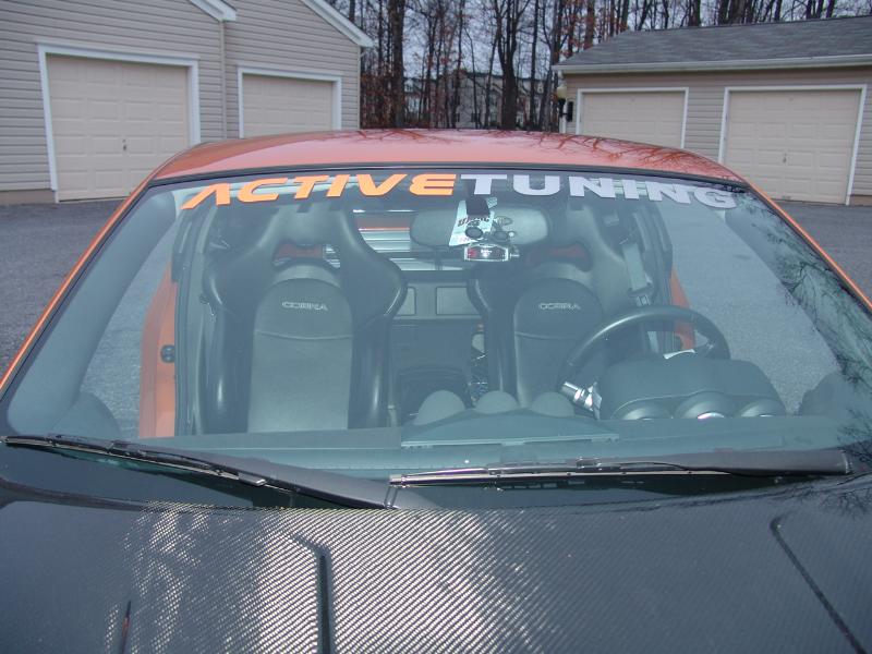

Numero dos

actually the seats are very comfy ... they use that aerospace foam stuff

Alright I've got it installed as best as I could. This is what I did:
The front tabs on the brackets where the bolts go in were bent 10 degrees. The door side of the passenger side bracket has two washers under each bolt....the door side of the drivers door has three. The passenger side fits perfect, no rubbing whatsoever. On the drivers side, I had to drill the hole on the back left side (there is a prong that didn't fit in the pre-drilled hole all the way) a bit bigger. The drivers side fits with no rubbing, but if I turn hard, it hits the door...not too big of a deal. I may try one more washer and see if that looks ok and works.
