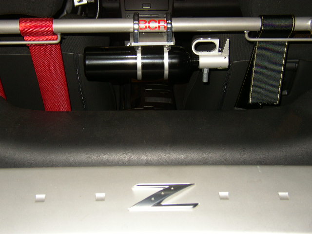

Just installed my new fire extinguisher with a billet head, billet quick disconnect mount, and harness bar mounting brackets!!!
I’ve been looking for a safe place to mount an extinguisher for a long time, and I decided that this set up is the best. “A” pillar mounts are potentially a hazard to a passenger. Mounting behind the seat slows down its accessibility too much. Mounting to the front of the seat tracks would get in the way too much for daily use.
My chosen mount allows quick access and is out of sight in the rear view mirror.
It’s a Halon 1211, 2 ½ pound cylinder.
I know they aren’t required for the HPDE events I run, but most organizations DO recommend a fire extinguisher.
Plus, I think it looks pretty cool!
I’ll try to find a pix on my brand new PC……..

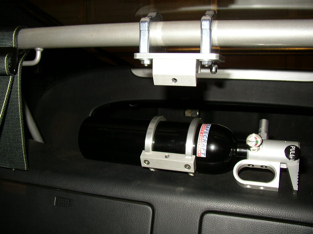

Another.....
Attached Thumbnails My New Halon Fire Extinguisher-fire-extinguisher-1-11-12-2-.jpg

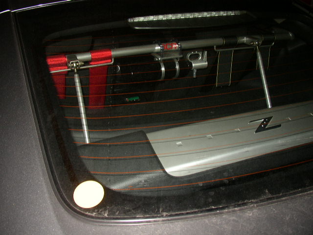

Disconnected.
Attached Thumbnails My New Halon Fire Extinguisher-fire-extinguisher-1-11-17-2-.jpg
