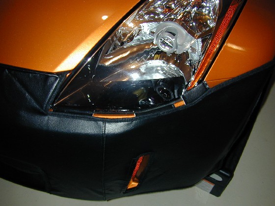

OK, I got the thing on, but what are these tabs for?
I assume they are supposed to go under the headlights but there's not room for the one in the corner.
Are they supposed to go under the headlights?

I bought a used Nissan Bra that didn't come with instructions.
Got it installed but what are these tabs for?
I assume they are supposed to go under the headlights to stabalize the bra but there's no room for this one.
Am I correct in thinking these are supposed to be pushed under the headlingts?

That would be my guess

The last tab bends to fit the curvature of the edge of the headlight as it slides into the gap - kind of goes up the side of the headlight.

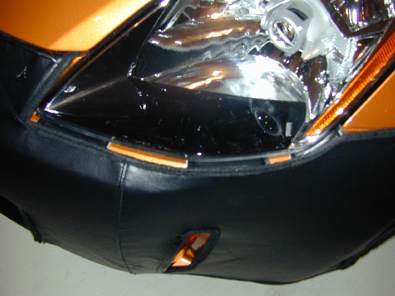

Cool, Thanks.
The gap on the side of the headlights on my car is way tighter than the gap below the headlights.
I was able to get the tab pushed in there by placing the palm of my hand on the headlight and pushing it toward the center of the car and then pushing the tab in with the other hand. It's very tight, but I guess that's good, it shouldn't come out. The passenger side was easier to do.

You will have to "screw" the supplied snap-screws to the fender wells. And pull the bra - snugly so that the 3 tabs will line up to the edge of the headlights...

that same tab on mine didn't fit, either, so i split it into two tabs with scissors, inserted the part that fit under the headlight, and tucked the part that didn't under the bra.

Yea, mines the same way. The only way I could get that tab in was wrap a rag around a screwdriver and pry the headlight and fender apart a little.
