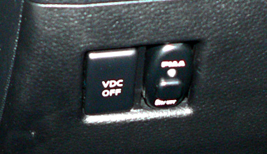

I have a set of PIAAs and modified the switch to fit in the factory location. A quick fix until I can get a factory switch like the one above.

just finished dremelling the stock covers for those switches, and put in a lighted rocker switch ($1.25). Will post pics tomorrow ... came out pretty cool

here's a pic of my $1.25 rocker switch installed
