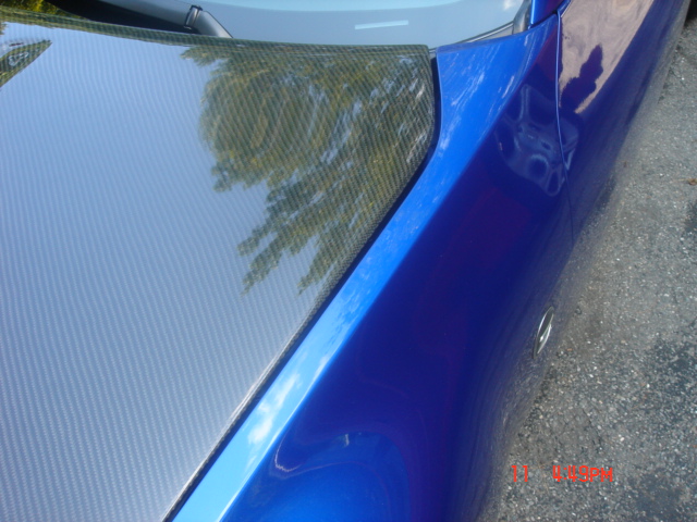

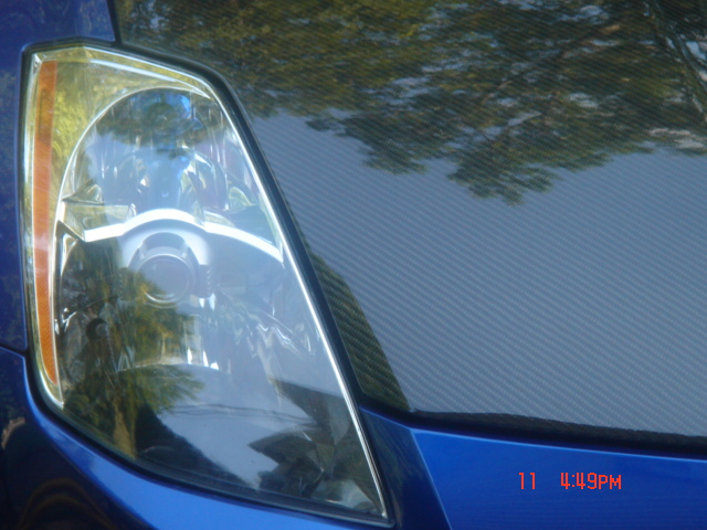

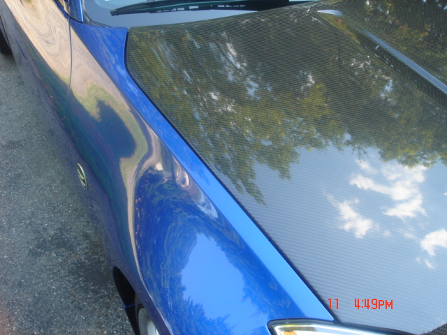

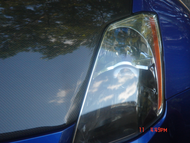

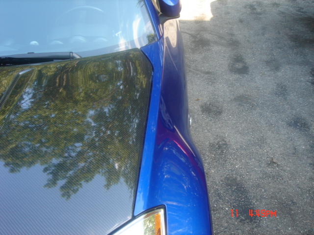

Here are the pictures.....
Attached Thumbnails seibon hood HELP!!!!!!!!-dsc00227.jpg   seibon hood HELP!!!!!!!!-dsc00228.jpg   seibon hood HELP!!!!!!!!-dsc00229.jpg   seibon hood HELP!!!!!!!!-dsc00230.jpg   seibon hood HELP!!!!!!!!-dsc00231.jpg

Looks like the drivers side hinge mount needs to move a little toward the front of the car... My 2¢

Looks like it will fit better than mine. My TS hood seems to be too narrow (gaps on both sides).
I agree with teh215. Move the driver's side toward the front of the car.
Does your hood latch correctly?
:edit: I just noticed that the front driver's side is too close to the light to move it up... um... I don't know what to say then.
