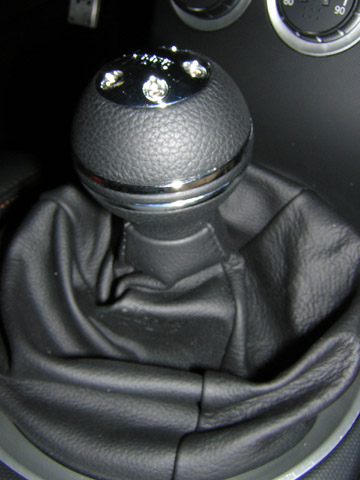

Momo Shift Knob and Boot Installed
Overall, a very frustrating experience.

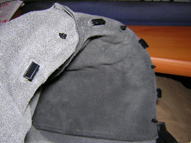

I have much room for improvement. I haven't really adjusted the leather in the boot the way I want yet, since I just finished the install. It was exceptionally frustrating because the Momo boot came with an elastic band around the bottom, which continued to get in the way over and over again. I had to cut this elastic thing off to make this project somewhat feasible. The aluminum ring that holds the boot to a hidden plastic ring uses these weird clips. I had to poke holes in the shift boot to get it to fit. The bad news is that the clips are pretty tightly stuck now, and it will be difficult to get the boot out if I want to. A small amount of leather is still bunched up between the aluminum ring and the console... which makes the console not totally flush. Well, at least I'm done, for now. I plan to do a little bit better of a job soon, to get things to fit and work out better.
I would rate my install 6/10... I could do it so much better next time.
At least the stock **** wasn't very hard to get off...with the right tools.
In the farther away picture, you can see how the console is not totally flush. I will fix that tomorrow if I can...

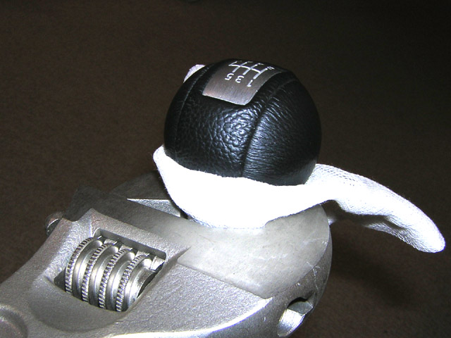

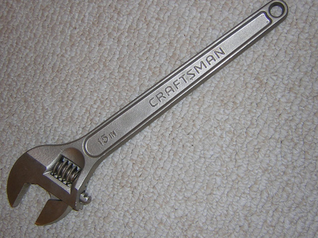

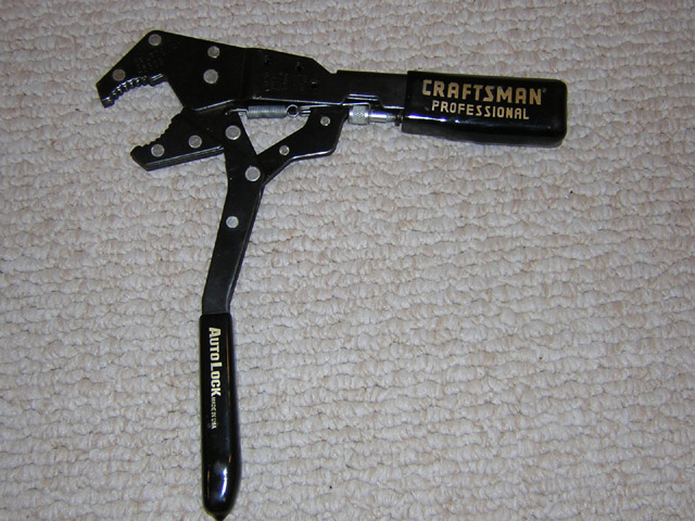

Some tools...
To remove the ****, I used the auto-locking wrench to hold the shaft (did not use any protection, just grabbed it through the rubber boot underneath everything).
I used the 15" monkey wrench to hold the shift **** and some regular cheesecloth to protect it. As you can see, it was not damaged.
The 15" wrench gave me tons of torque to get the **** off. It could be done with a shorter wrench, but it was super easy with one this big.

Originally Posted by atar350
It looks good, I had a full MOMO interior in my 95 VR4, but it must be hot where you are, that boot looks loose and saggy....Peace!
LOL ... I assume you're just breaking my *****...
I already cut off about 1 + 1/4" of leather from the boot. It's not really saggy, it's just that there are a lot of curves and folds; there's more leather there than there needs to be. I might cut off another 1/2 - 3/4" of leather to make it look a little cleaner. For now, it doesn't impact performance whatsoever, so I'm cool with it.
I did this install from like 11:30pm - 1:30am, and I was too tired to make it perfect how I wanted. You can always trim off more from the bottom, but you can't put it back
so you have to do it little by little. Plus, leaving the boot a little baggy is ok. Look at this guy's install...
https://my350z.com/forum/2003-2009-nissan-350z/133163-had-some-free-time-and-jet-lag.html
It looks like he did not trim off as much leather as I did from the boot.
