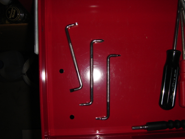

Jack the car up and with the lower splash guard removed, it can be done without removing the bumper. But... the passenger side one will be near impossible if you don't have this one screwdriver to do it... it looks kinda like a squared S... it's about 5"? long and the two ends are bent at 90degrees so you can squeeze between bumper and washer fluid resevoir. Without removing the bumper, you'll most likely spend 90% of the time on the passenger side.
-edit-
Here's what the screwdriver looks like...

I finally got it! Thanks dkny boi! Will post pics soon...
