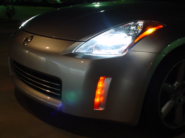

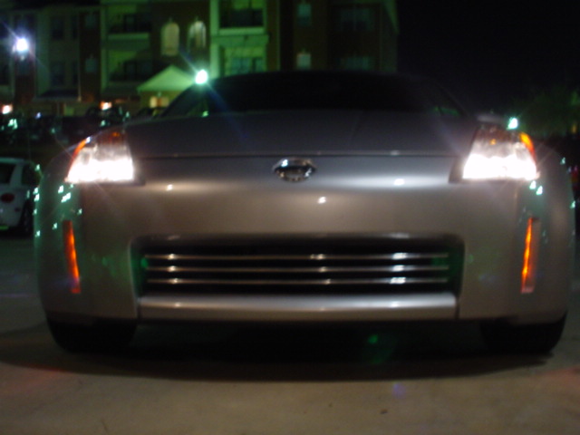

chrome silver with stricklyz side markers
pain in the *** to install....doing it at night sucks...even harder with a flashlight that keeps blinking on and off.
Looks good though......LED's need to be yellow..not clear it would match better.
The pic makes it look better.

-----I one big complaint about the side markers-------- is they dont match the factory orange with yellow light bulb in the head light....Strickly Z should put yellow LEDs in the side marker to match the color correctly....But the cool thing is that the picures make it look like it matches.
