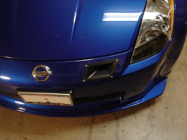

UPS dropped it off this afternoon and only took me about 30 minutes to install. Thanks to tortuga for the heads up on splparts.com. This picture isnt the best but it was already dark outside.

how do u put them in?

It comes with a template that you use to cut a hole in the bumper (I used a Dremel). Then you just put the duct in and secure it with the four screws that come with it. Pretty easy actually.

Also, you may want to buy some different bolts to attach the duct to bumper. The phillips head screws that it comes with allow for an easy theft of the duct. I recommend a bolt that has a flat head with a nut to tighten on inside of bumper. Just an FYI.

I may end up going with some black rivets instead of the screws. Thanks.

Nice! Go to any body shop and ask for the black plastic rivets. Looks much better IMO.
