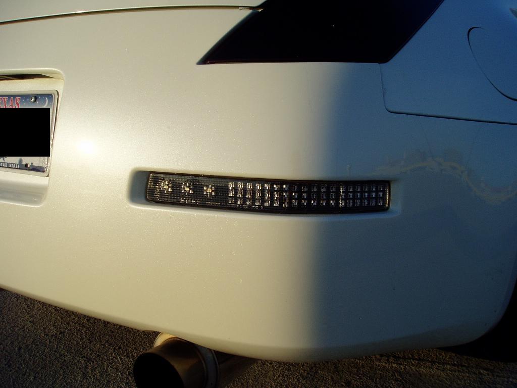

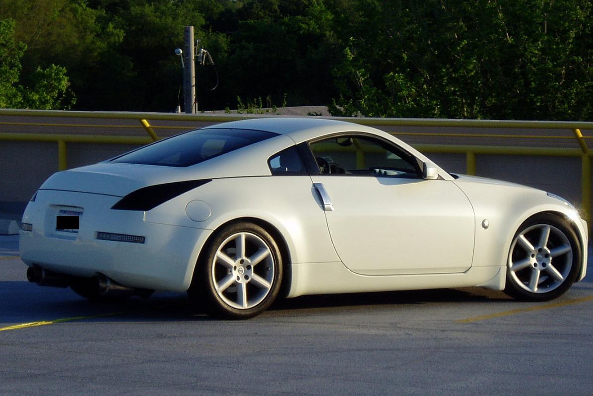

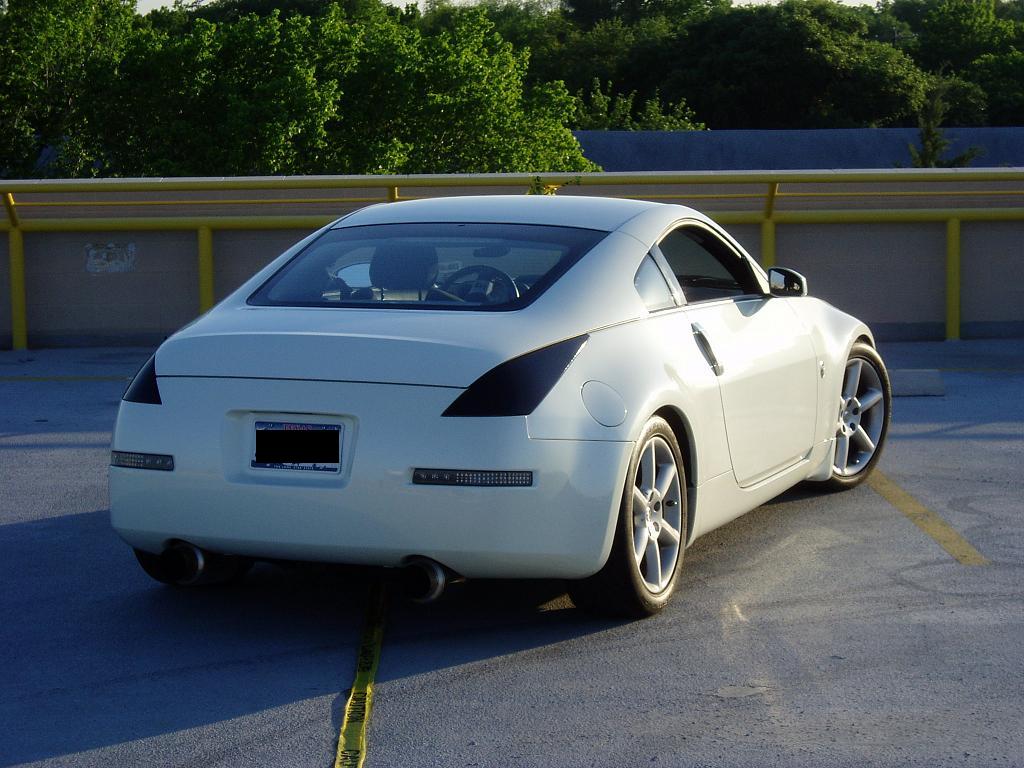

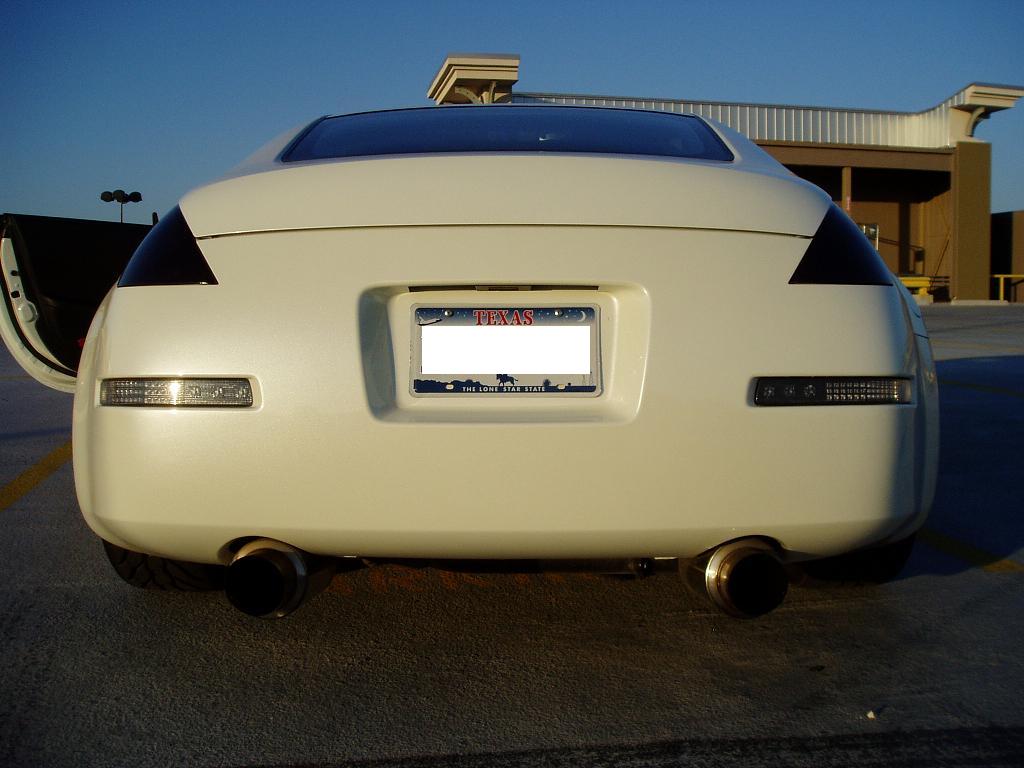

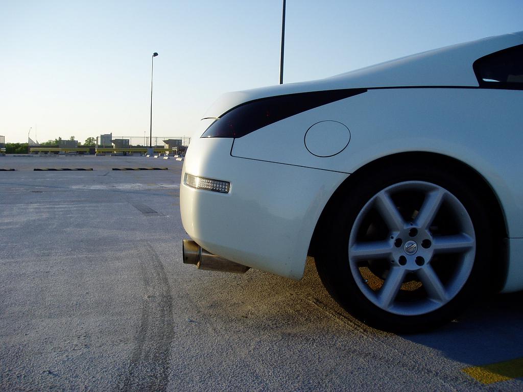

I thought I would post up some daytime pics with both sides finally installed. Here's some eye candy...
-Acree

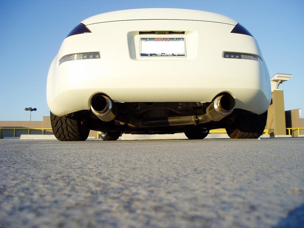

One more pic...
-Acree
