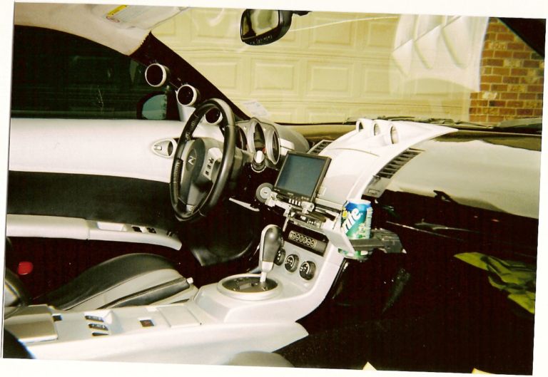

i did mine last week..takes some patience
Old May 6, 2006 | 10:00 PM
  #70
abyss's Avatar
abyss
Posts: 4,318
From: Missouri
wow nice. I love your interior turbo. that white flows nicely.

yo turbo350 where did you get your white 5AT central panel? i want a grey one please hook a brother up man
paint it.
Old May 8, 2006 | 07:31 PM
  #73
Turbo350's Avatar
Turbo350
Posts: 117
From: Louisiana
i just painted it bro..my WHOLE interior is painted everything all the way to the back..going to get more pics the only thing thats not painted is the roof
