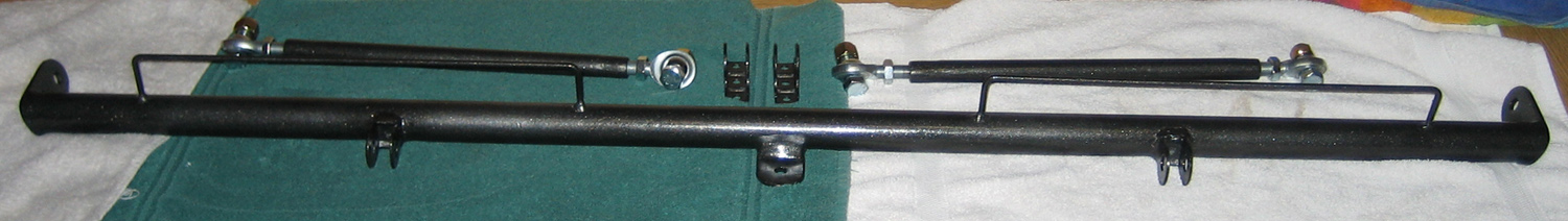

thats cool, how you mounted your Nos tank. Im going to build my own, since i have my own tools. I ordered my harnes from summit racing.

snap james, how would u go about making one urself, welding? or bending?
-b-

both

o sweet.this is a guess, are the bends mandrel or is that just with exhaust? and also what kind of welding?
-b-

Im not using exhuast tubing, using 1.25dia .125thick seamless tubing. Im going to try using my hydraulic tube bender. Depending how im going to make this, i could Mig or Tig it, I have both

Ok guys, took me awhile, but here it is. My harness bar idea i got from the "bcr harness bar" I liked the look and how it mounts. So i went and took sometime and created my own. For me i didnt feel like spending $500 on just the bar itself, so i made my own. I think i spent about $250 and that encluded the a 5point G-Force harness. But i can see how the BCR can be $500, the time and labor. Here is a picture of my bar unmounted.
