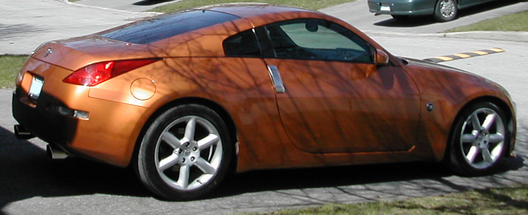

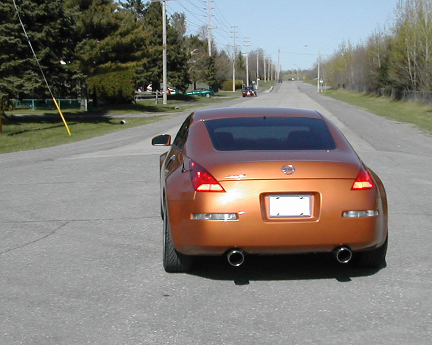

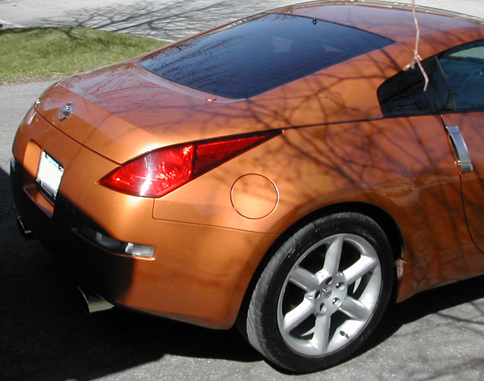

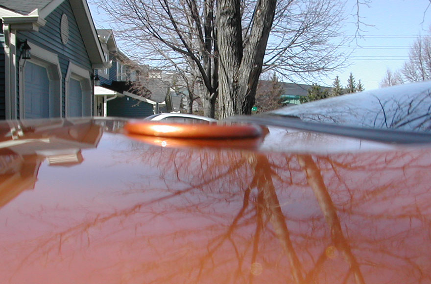

I love when I see 350Z's that have smooth lines. I think it makes our car more sexy and shophisticated. So I knew I had to take of the rear wiper to achieve the ongoing look that I want for the Z. Pictures were taken with a 7 year old camera so excuse the quality.
On a difficulty scale of 10, this mod is rated a 1 by me. Could have taken me less then 30 minutes if I didn't have to chat with a neighbour.
I knew I wanted to do this mod so I madee sure I got the body shop to paint a facaut stopper when they were painting my lip. I suggest others remember to do this if they ever get anything painted. This way if you ever decide to do this mod, you have a painted stopper already done.
And yes, I know I need new rims

I went to home depot, went to the plumping section, and asked for a faucet stopper. And lucky for you, I was neurotic enough to save the wrapper. It's from the company "LDR", it's labelled as "Faucet hole cover".
There is a couple of serial numbers:
The one under the bar code is: 0 19442 12522 6
The other one is: 501 B6415WT
Good luck!
