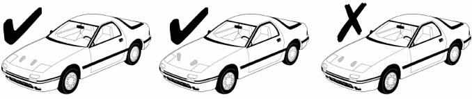

Originally Posted by JDMZ33
Here is one one silver and under hood mount.
Those catches are installed backwards. According to Aerocatch:
The preferred AeroCatch mounting is noted below with the narrow end towards the front of the car and either into, or at a slight angle to the airflow.

Good Eyes.
