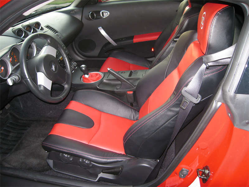

Alrigh.......installed the seat covers, handreasts and shift boot last week, but haven't had a chance to post pics on here. I got all that ordered from LeatherSeats.com and pretty happy with it. As far as the quality of the leather, I give it 99 out of 100, it took me about 8 hours to change the covers, which was really hard and not fun. I give it 90 out of 100 for the fitment of the covers. I am really happy with this buy and would recomend it to anyone who's looking for aftermarket seats or covers. Here is the pics, check it out...

Man that looks sweeeeet!! Now you HAVE TO do the E-brake leather install. Check for the DIY posted by anyone2u. It's REALLY easy!! And with the set-up you already have it will really look tight. I did the e-brake in leather and it only took 45 minutes. Looking good!

You will find that the leather will tighten up and remove wrinkles as it stays on...a effect of heat etc. So bottom line, the install will look better later.

I've done two recovers with leather kits - a Jaguar and an Austin Healey. In both cases I initially had some wrinkles, but they disappeared in a few months of sitting on them, season temperature changes, and keeping them flexible with leather conditioner.
Keep them lubed (leather is skin), and they'll maintain good flexibility and conform great. Remember - leather dyes are colorants, not oils, so don't let the new skins dry out in the first few months.
