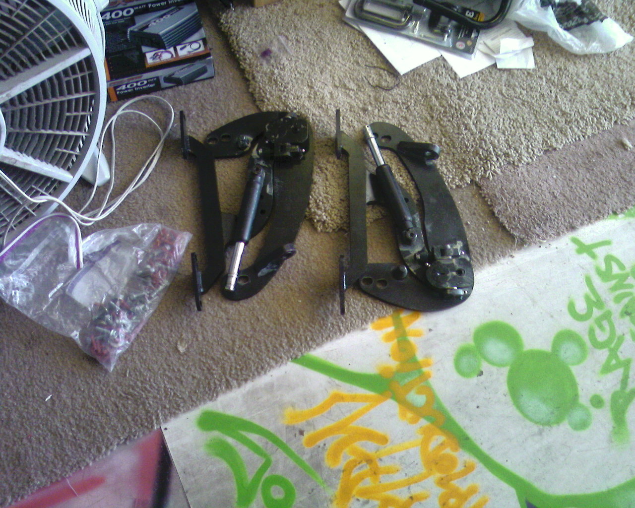

Im going to take pics of the hinge kit (still in the box)
to display to the forum what the VDI kit has.

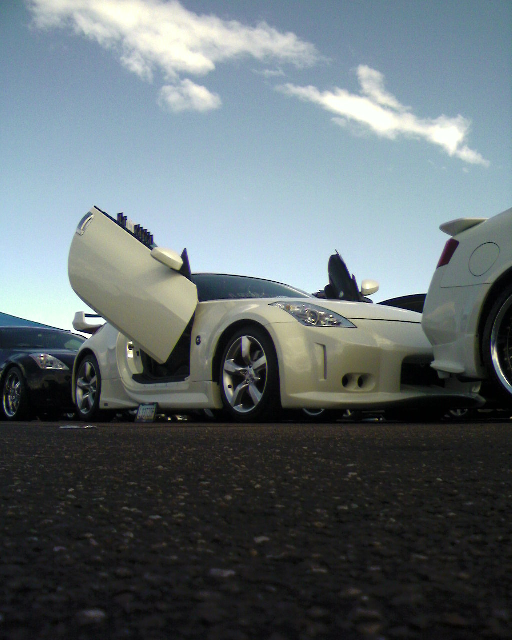

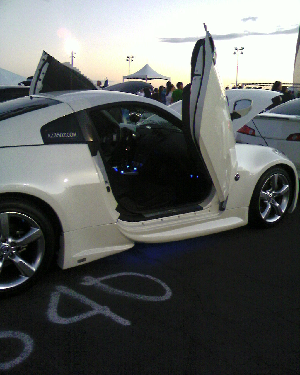

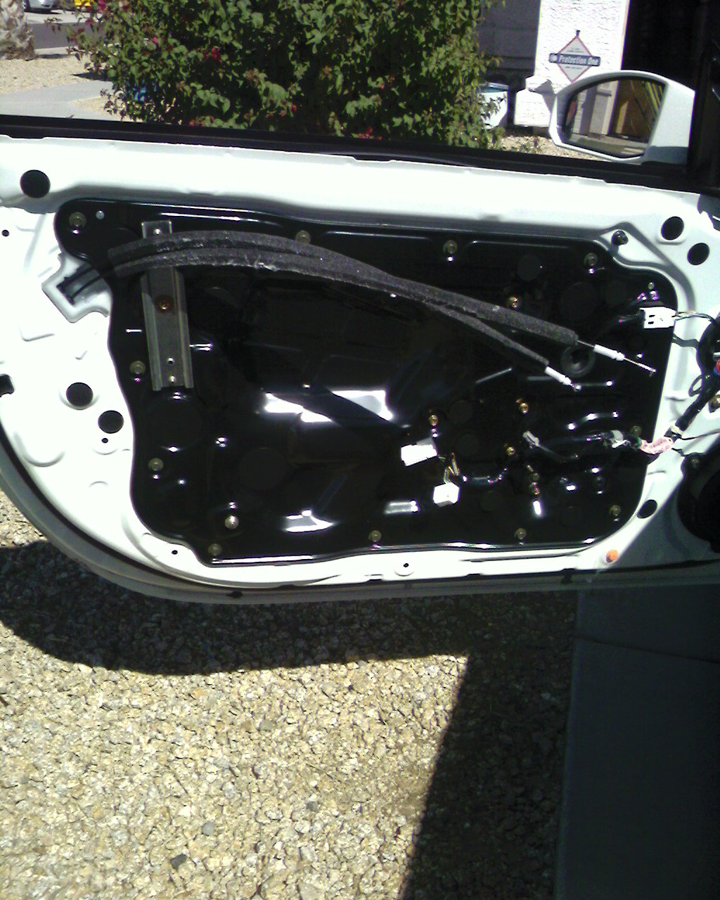

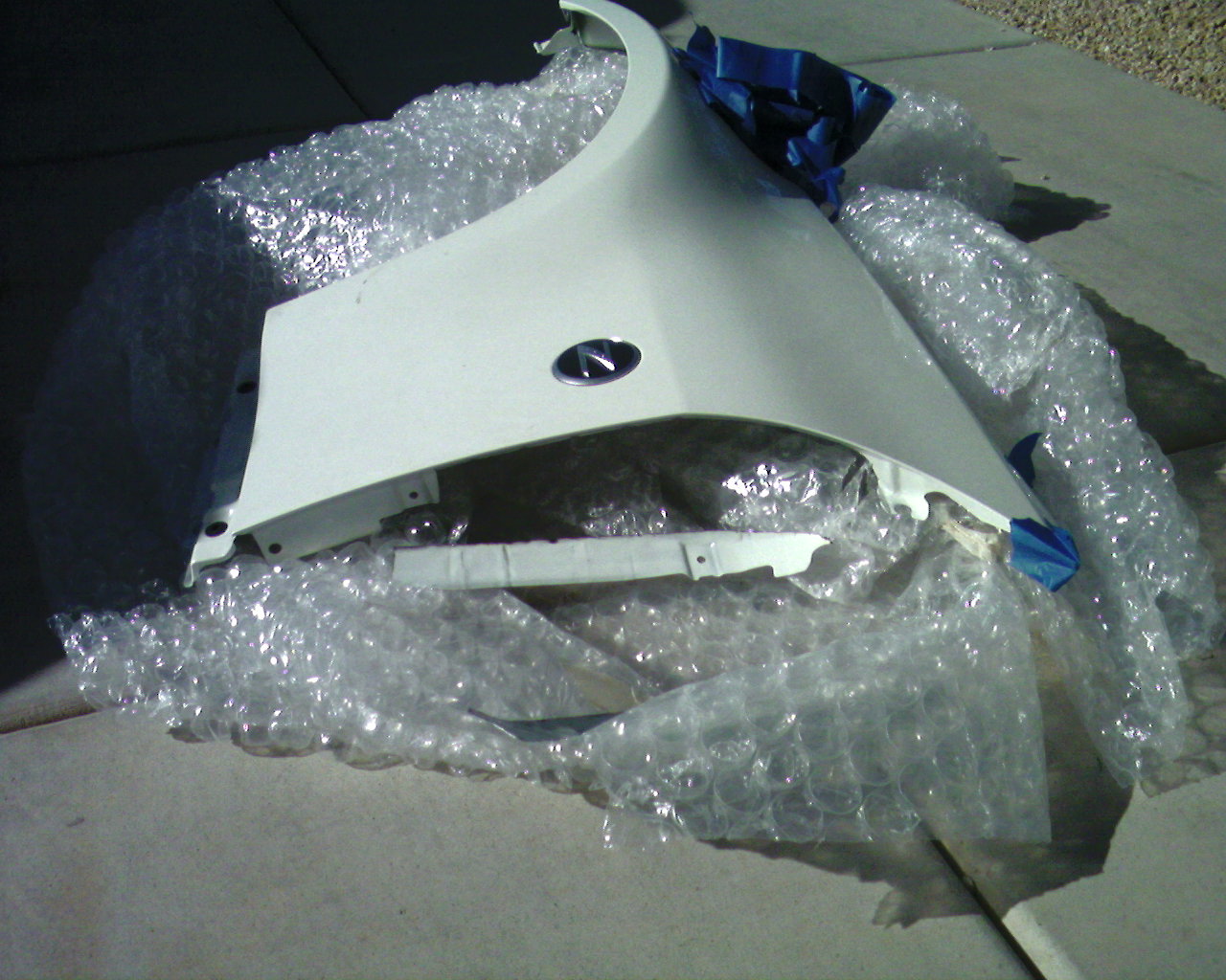

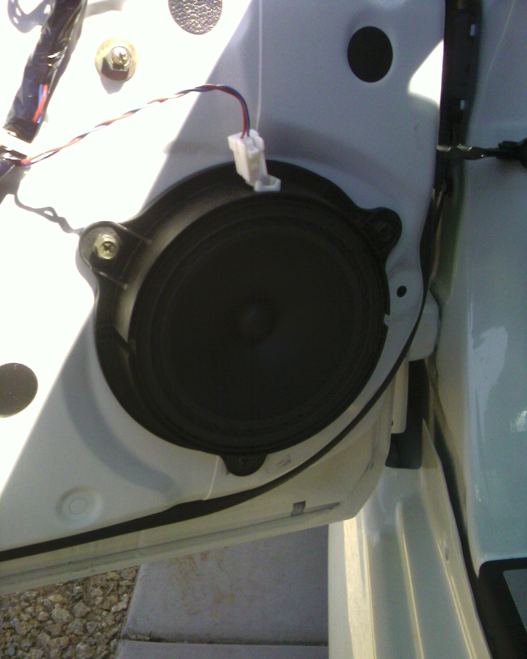

OK, I did my best and it came out great IMO.
notes...
I FORGOT TO TAKE PICS OF THE DOORS TAPED. USE WIDE BLUE PAINTER MASKING TAPE SPARINGLY TO HOLD DOOR ONTO CAR.
I didn't even need a second person to make sure the door alignment didnt move any.

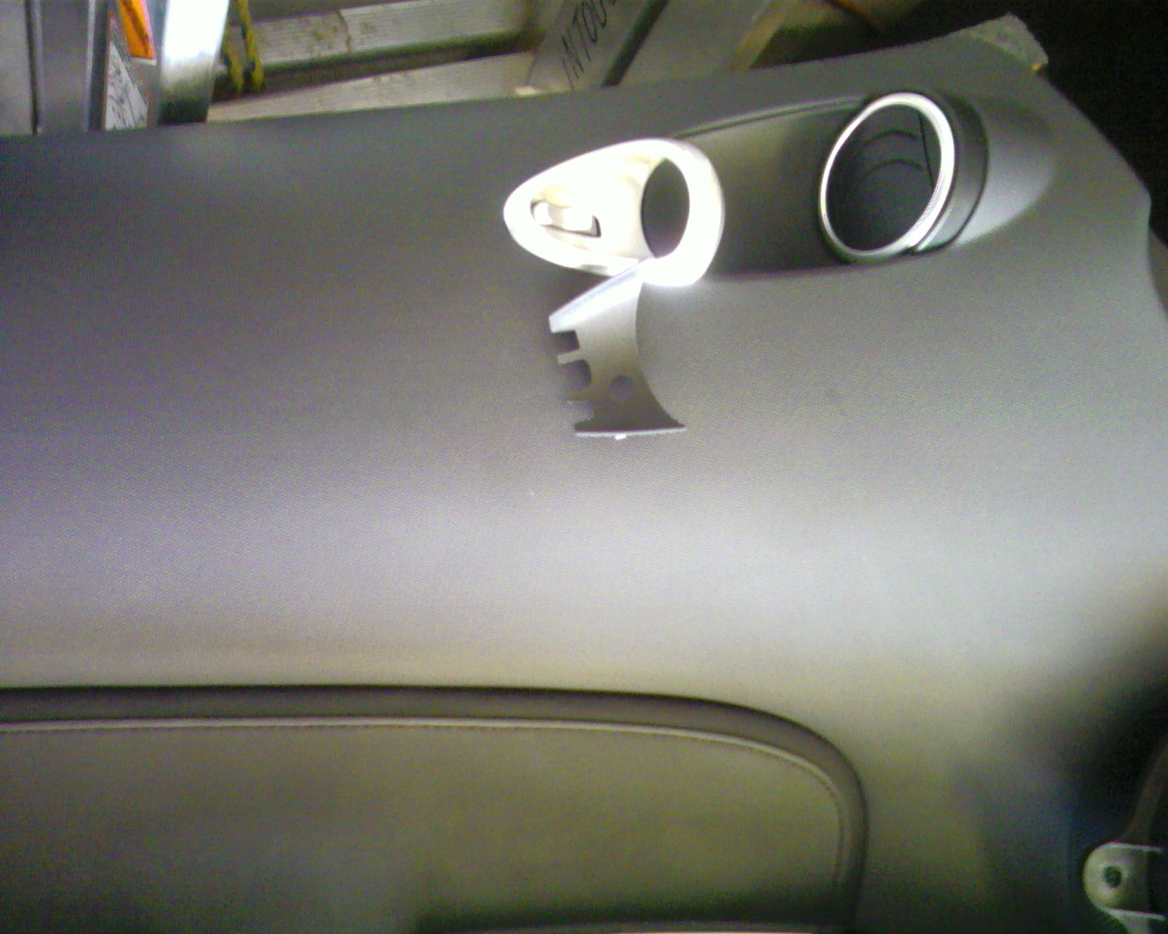

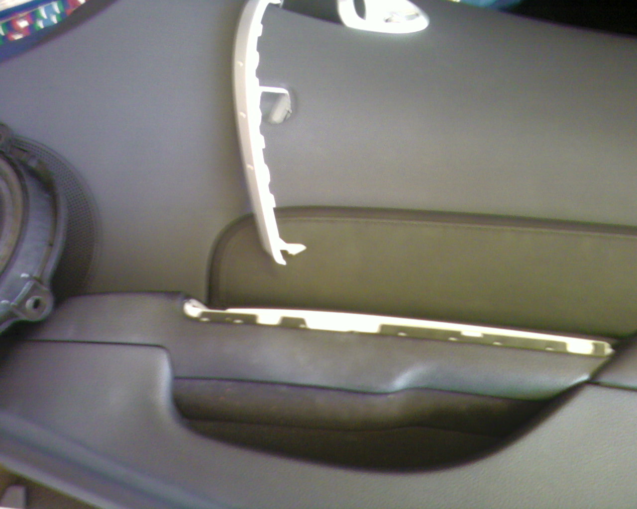

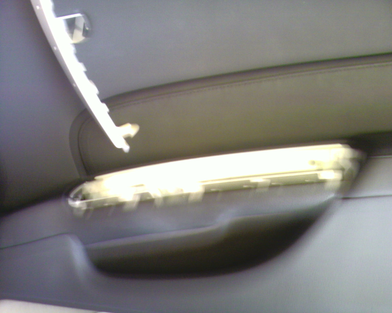

After I got the fender off, and before I took off the stock door hinge, I unloosened and then tightened each of the door hinge bolts on the body of the car and on the door one by one so that i don't run into alignment issues being a brute.

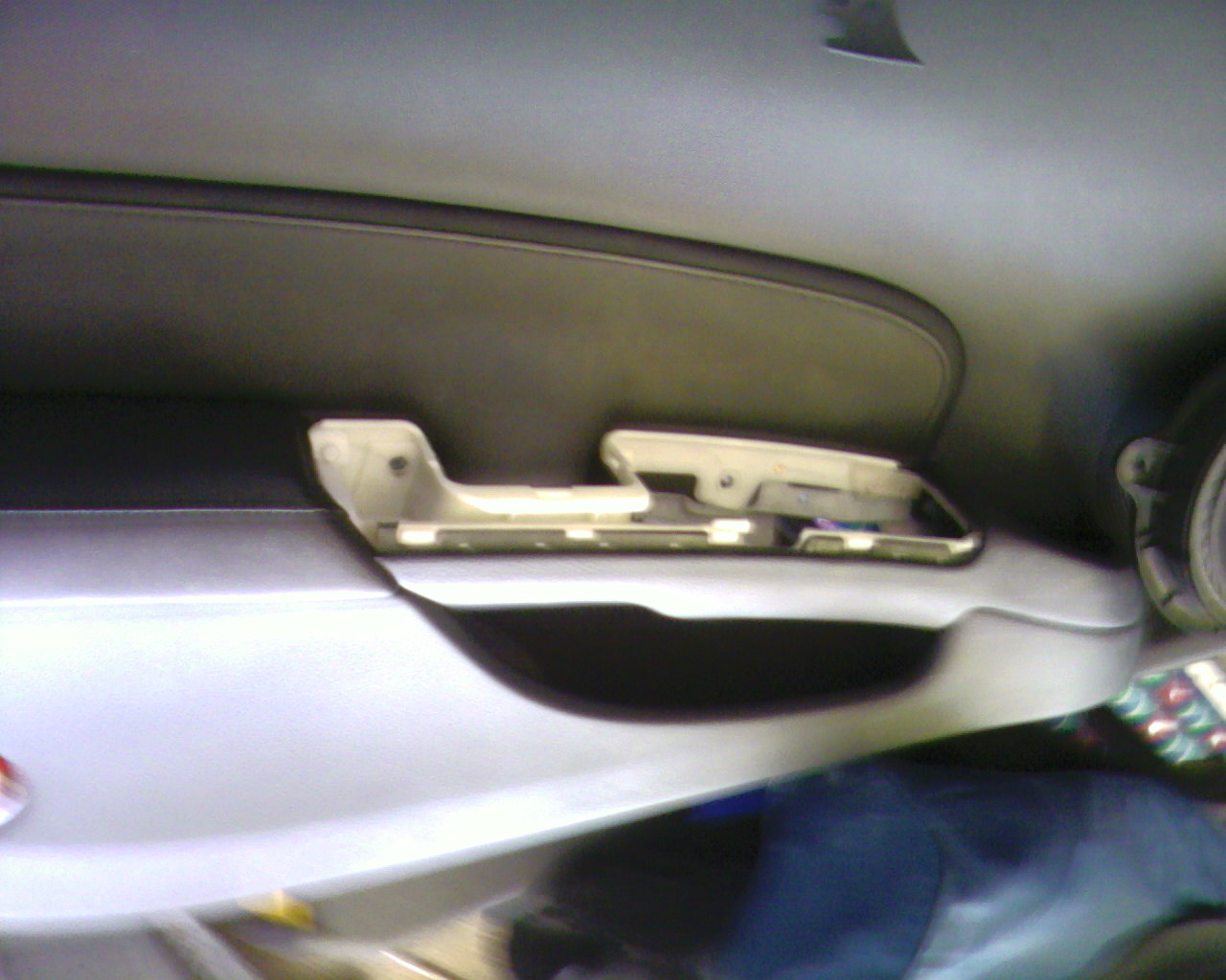

when you remove the door panel, there are differences between the driver and passenger doors. The passenger has a handle.
on the pic showing the door panel off, there is a small plate just behind the door handle, it doesnt require any unscrewing but just either by hand or a small screwdriver, pluck it out. behind there is a 10mm bolt.
there is a chance you are doing this project p/m, post or email me ron@l33tzor.com
Ron
Here are the pics using my Phone camera.
Here is a link to the pdf supplied by VDI. (Thanks VDI)
and here are the images i stopped to take during progress.
http://www.l33tzor.com/doorinstall/V...%2003-2004.pdf
(The image shows a 350Z but I believe the doors were some other Nissan product).

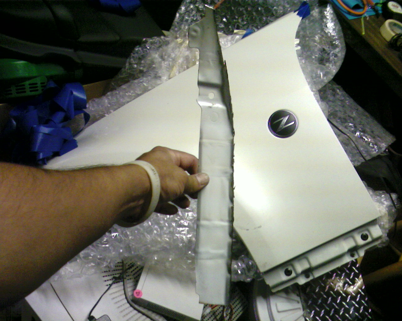

Once you get into the project, it will become quite apparent where (i.e. how much) of the strength rib you need to cut.
NO, BAD WAY TO EXPRESS!! TRAIL AND ERROR IS NO FUN AND ABSORBS TOO MUCH TIME.
I don't have any pictures, but you can basically mount the door then hold the fender up and see how much travel room the hinge requires. Wouldn't be hard at all.
NOW THAT I HAVE SEEN ACTUAL WORK FROM VERTICAL DOORS INC ON A FRIEND'S Z FROM THE TEAM I'M IN, TAKE MY PICS AS WHAT VDI DOES.
