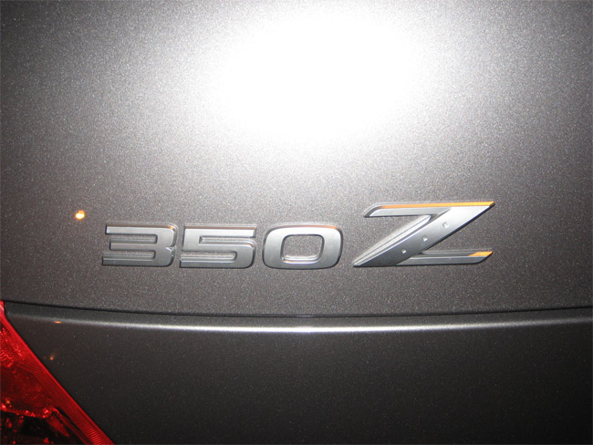

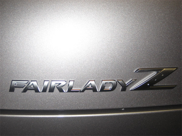

I just wanted to thank everyone for their help and input.
The first thing I did when I got home was I yelled out "Tony! I need a blow dryer, goo gone and dental floss." He immediately replied with: "Who do you think you are Macgyver?"
After the laugh we went down to the garage and followed the steps as described and it took us no longer than 10 minutes to get the entire thing off including all of the adhesive. The only touch I added was while I was holding the blow dryer I had him pour goo gone just above the letter. After the letter came off, I rubbed the adhesive with a microfiber towel and it immediately came off.
Putting on the Fairlady Z emblem was as described above, couldn't be any easier. Here are some pictures:
Attached Thumbnails Removing Stock Embelms?-before.jpg   Removing Stock Embelms?-during.jpg   Removing Stock Embelms?-after.jpg   Removing Stock Embelms?-after2.jpg

are there any measurements for where the fairladyZ goes or did you just slap it on there...
Old Jun 19, 2007 | 07:04 AM
MarkY's Avatar
MarkY
Posts: 150
From: Arizona
It should come with a foam template.

hey guys, i just debadged the 350 Z badge with dryer and floss like everyone was saying earlier
my problem is, i can still see 350 Z imprinted on the hatch... it's like the sun baked the image on there...
question is, should i just go ahead with the fairlady badge, or should i do something about the faint 350Z image?
thanx in advance
