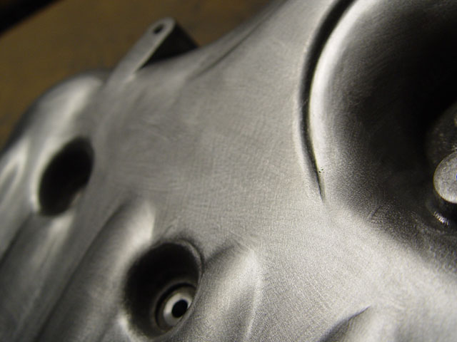

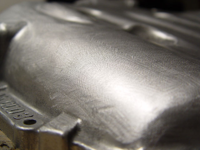

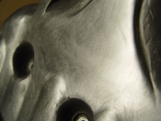

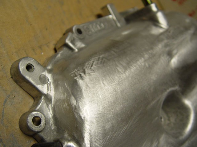

so the idea was to polish my uper intake in the downtime i have at work, it started out ok. i used a air powered wheel to remove all the casting marks.
this went ok, but now i have a bunch of indents where the wheel dug in any tips on removing these since trying to sand them out by hand is taking hours, and i am ready to just paint this thing.
on with the pics
Attached Thumbnails DIY gone Bad!!-dsc03771.jpg   DIY gone Bad!!-dsc03772.jpg   DIY gone Bad!!-dsc03773.jpg   DIY gone Bad!!-dsc03774.jpg

sounds like too much RPM's and too rough of a pad...
get a softer pad attached to like a dremel...something that you can set the rpms and there is no way of going over...try a 18 volt drill maybe too.
take your time...

Black and decker mouse sander for larger flat spots....

DA sander.

A dremel is a waste of time, these are way to big(plenum). you need the right tools for the job

if you're going to paint it, get some bondo or JB weld and fill in the bad areas...go over it by hand and make it all smooth, then paint.
...I did mine like that and am currently painting it. (I removed the 5 long humps, and 6 bolts in the middle)

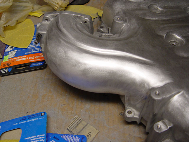

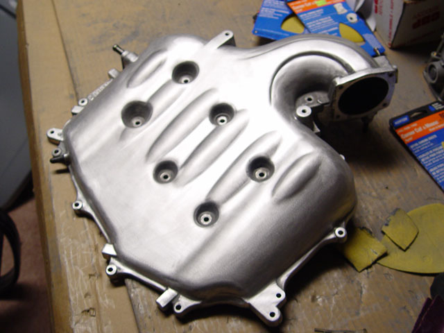

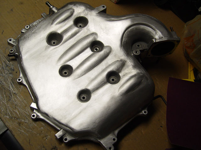

i put some time in tonight and its looking better
Attached Thumbnails DIY gone Bad!!-dsc03818.jpg   DIY gone Bad!!-dsc03819.jpg   DIY gone Bad!!-dsc03820.jpg   DIY gone Bad!!-dsc03821.jpg

People dont realize how much time this takes, now you know buffing it out is just as fun.

looking good! I think the polishing part is the hardest...it's so hard to make everything look clean - good luck and thanks for the pics!
