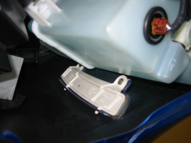

on drivers side you can install them by removing the wheel wells, they come off with 2 screws and 3 rivets. then the reflectors are held in by 2 screws from behind. thats easy.
on passenger side you have to pull the bumper away partially because the windsheild washer fluid is in the way. this gets a little more involved, but still just involves removing some screws and rivets from both under and above. as for wiring, its a simple 2 wire hookup, you just have to locate and tap into lines that are already there. not too difficult.
Im 99% sure that if you buy lighted ones whoever made them will give you very detailed directions with them. as for just buying and installing, there are guides on here, by skidazzle I think about "bumper removal" a search should turn it up.

yes, the driver side is really easy, but the passenger side is pain in the A$$!!
