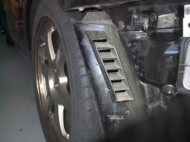

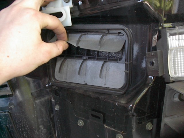

changed out my rear bumper today, and took some pictures of whats behind there.
I smell weight savings. who needs all that safety stuff in there. useless! JK
this is behind the rear wheel, no clue where its coming from, but its some sort of vent.

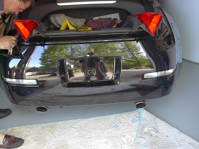

here it is sans bumper. it was a bit of a job to remove, but Ive done harder stuff.

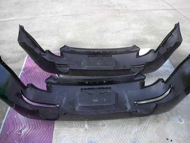

IM SEEING DOUBLE!!!
old and new

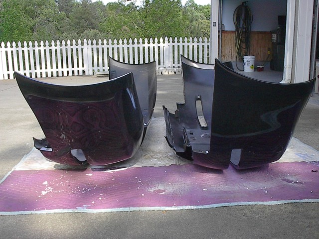

side shot of the 2 bumpers.

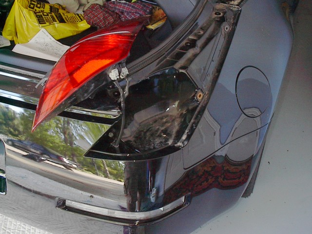

new bumper installed, and this is with the tail light out.
for those considering smoking their tail lights, the tail light is the easiest thing Ive ever taken off the car, 3 10mm screws on top under those caps, then pull straight off to the side of the car to pull out 2 pegs, then disconnect the wire, easy as pie.

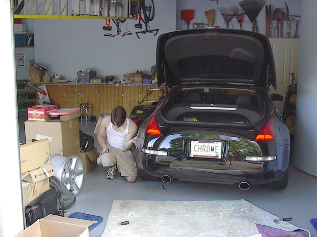

From: ATL
this is yours truly putting in the last bolt, being hampered by the damn tire in the way. I was hot as hell so I starting stripping half way through, its also laundry day so wife beaters was what was clean.
wise cracks=ban.
hope you enjoyed the pics.
