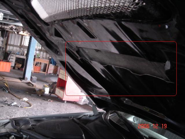

I cut the underside. Still more than stron enough. Washers is just hoig to make the hood stick up to high at the hinges.
wow...that looks great

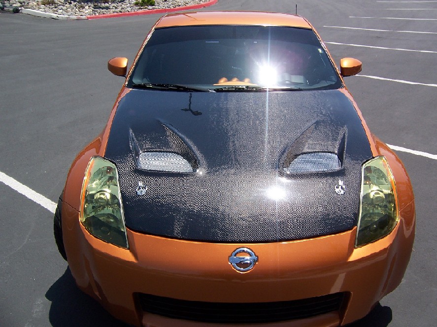

Default Cut it
I cut a hole under my VS II hood.
