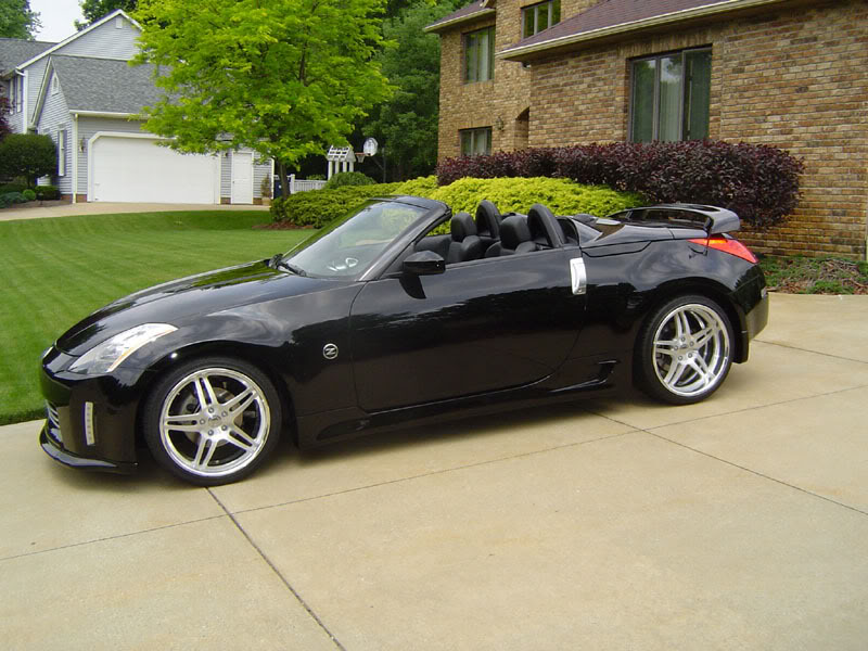

It's not an '06 but it should help you picture what the car would look like. The person that owns this car is on this forum as whip24lash.

Nice thanks for the pics man. Keep them coming if you can find them. I keep searching and still coming up empty.

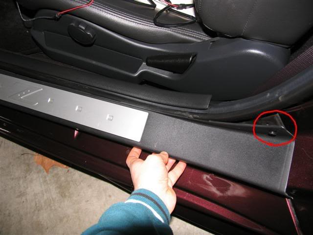

I installed them with the help of a buddy of mine. Anyone2u wrote a terrific DIY here on the removal of side skirts. Taking them off is very easy for one person but putting them on you would need a helper most of the time because it's a snug fit.
In my situation...the bolts that came with the kit were way too short. As I told Nothingremains & other members here... I went to the Auto Zone store & bought 2 pkgs. of 5/16" Doormand brand rivets (15 pk) code 799-100. It would even be better if they were slightly longer but these worked out great. I bought extra just in case I snapped one off. The white grommets on the body part, I removed & just attached these black rivets.
When installing, it's best to block & jack the car up a bit for better room. The kick plate needs to be lifted a bit when installing the side skirts. To show where the kick plate is open, here's a pic that I saved from another member. You can do this yourself (& buddy) & believe me you don't have to spend the money at the body shop. I did have the paint shop paint the screening black as the same color of the side skirts that might of been a mistake but it does look good either way. Good Luck!
