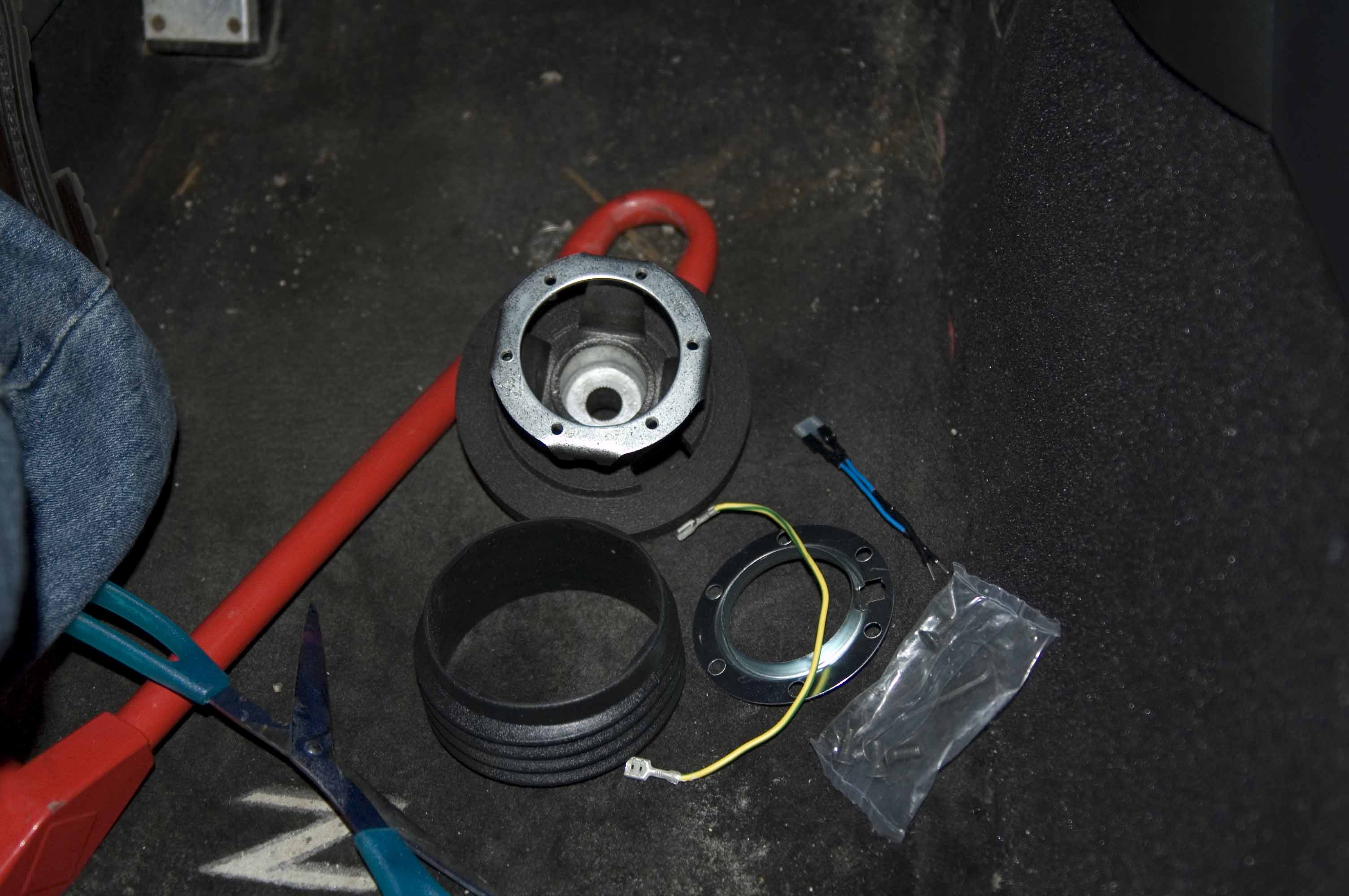

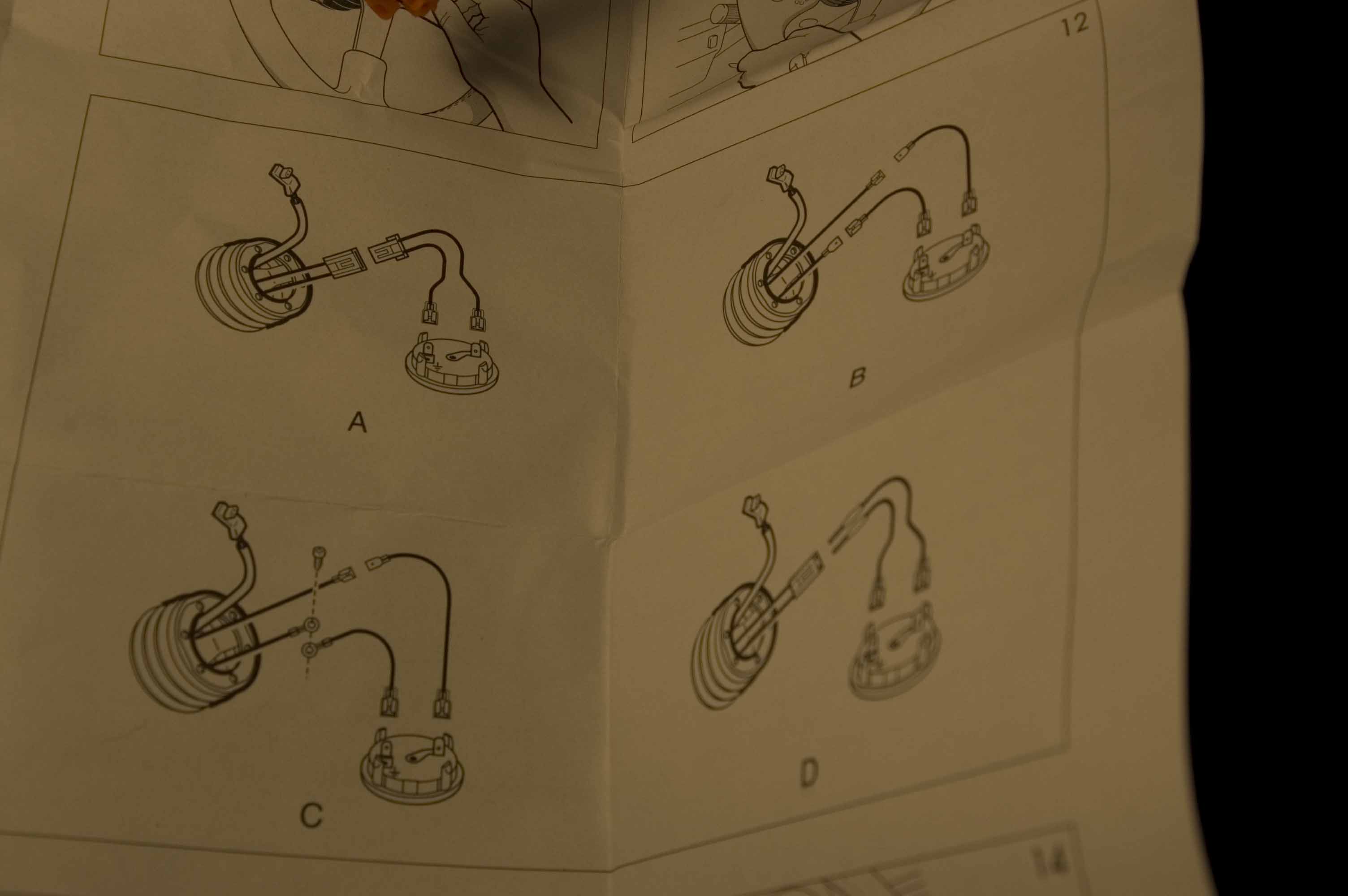

Alrighty guys i need some help i think on the new momo steering wheel i got in. I removed my old touring steering wheel just fine. However I'm concerned what to do with the remaining wires and how to hook the horn back up.
I've included pics of what i have on and what i have to work with. Can I just cut those two wires with clips off? are they just for the air bag? I'm assuming the green wire is for the horn and i just hook that to the new wheel positive. let me know thanks!

i havent done this but i don not recomend you cut the wires.......just incase you ever want airbags, becuase i thing the next person who buys you car would like air bags...........

first off you need two resisters to fool the airbag sensor and both the yellow and orange connectors require a airbag sensor. Or you can just have the airbag light blink all the time.
The positive for the horn is that green wire running from the spiral cable. You would connect that to the positive for you horn on the new steering wheel and then depending on what type of wheel you brought there should be some sort of ground connection, either via a wire or the steering wheel itself.

Search for a thread on how to reset the airbags, it works, I did it with my install. Yes green wire is horn. Tape the other wires around the steering column. (wrap them around and then tape them).
It looks like you are using the Momo hub (bad choice), they have been known to cause problems, do yourself a favor and get the Works Bell, it also comes with the airbag delete resistors that work.
Good Luck!

I'm not sure what you mean the horn button is not centered with the works hub. Do you mean the tab is in the way of the horn button? If so just tweak the tab on the ring downward so it doesn't touch the horn button.
The one wire from the car will get conected to the center tab on the horn button. If you have a quick release it will go to the contact point that will end up going to the center tab on the horn.
Then you will run a wire from the outer horn tab (thats the ground wire) to the other electrical contact pont on the quick release. Then on the back side of the quick release you will attach that ground wire to that metal ring with the tab.
