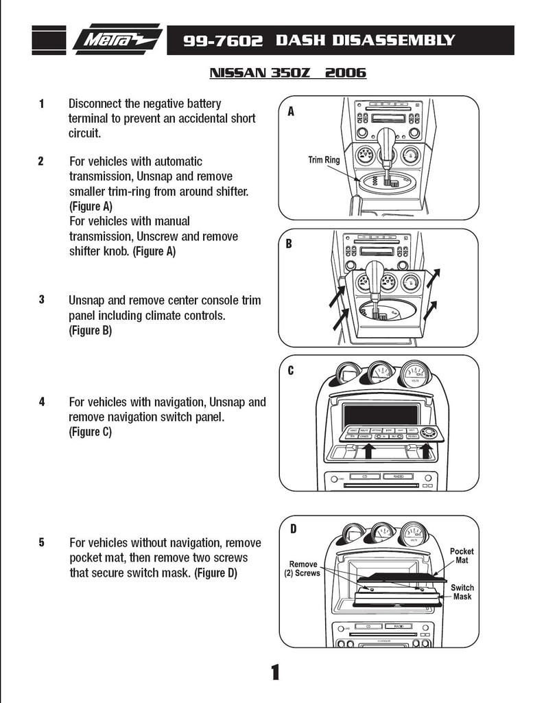

It is not as hard as you guys are making it out to be. It is actually a very easy dash to take apart. The screws directly above the radio in the cubby hole are behind two plastic pieces that you have to pop out after you take the mat out. Here are the instructions directly from the Metra kit (99-7602).
