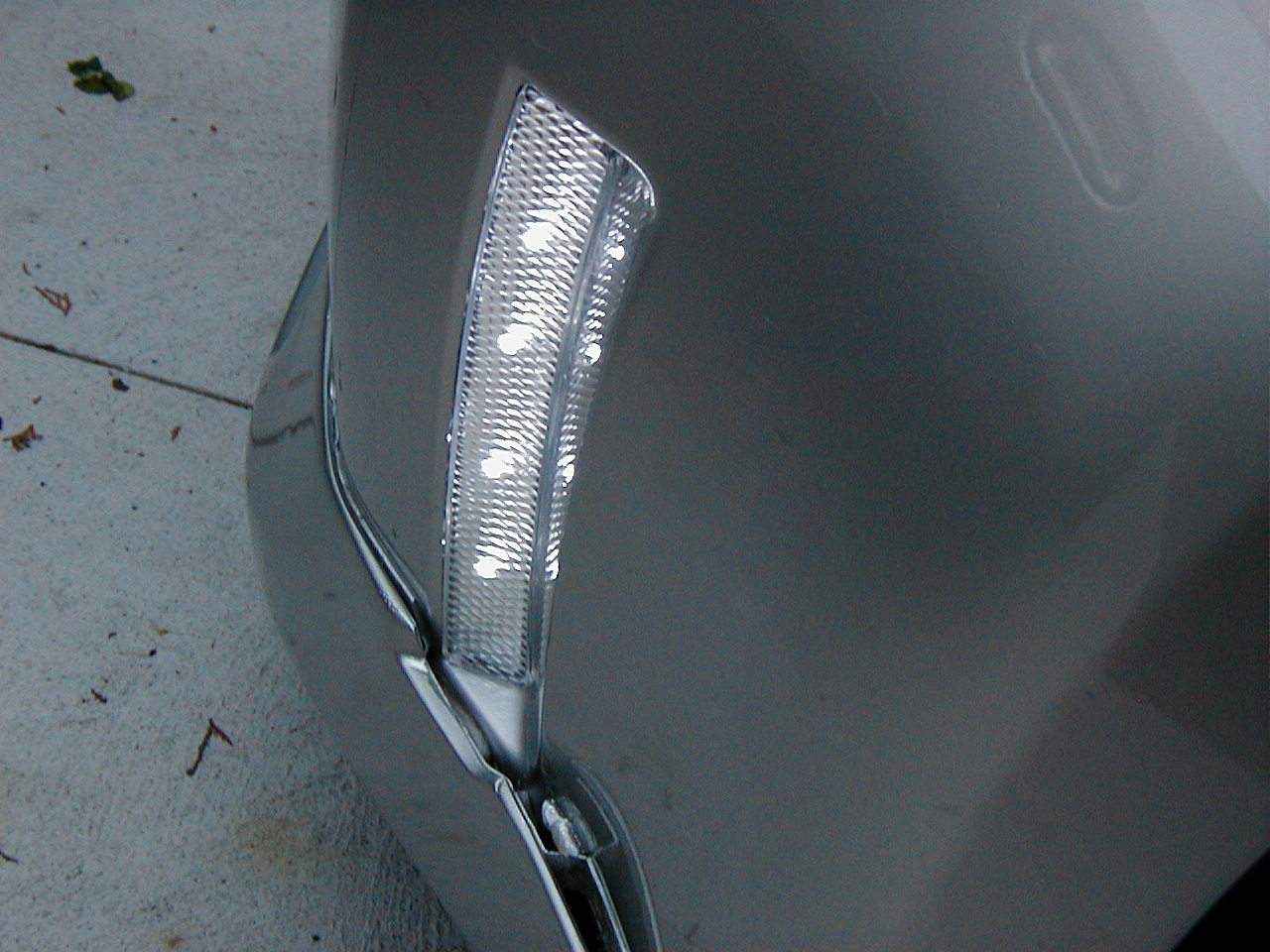

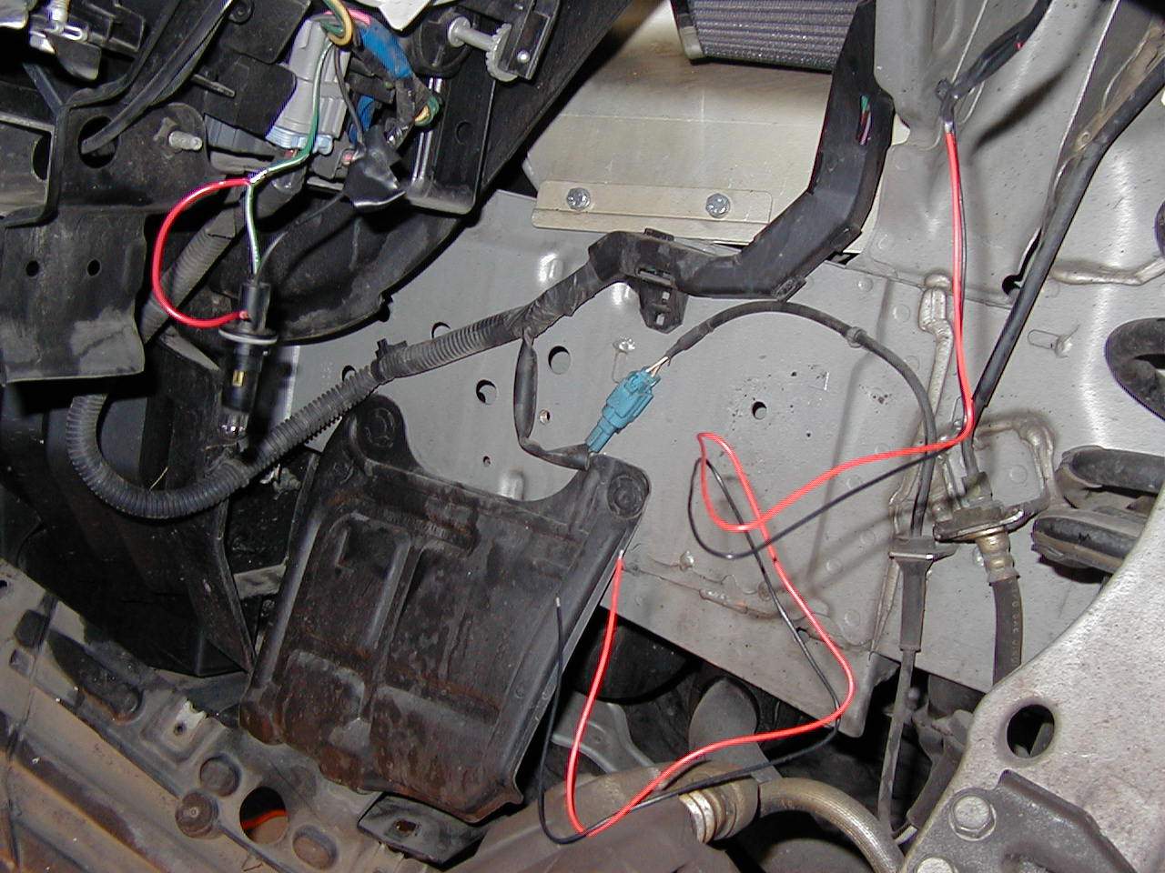

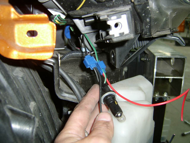

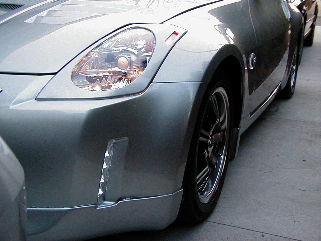

pictures
Attached Thumbnails How to take apart 06+ bumper reflectors...?-p1010085.jpg
Old May 10, 2008 | 04:33 AM
Agentman03's Avatar
Agentman03
Posts: 417
From: Erie Pa 16503
more pictures
Attached Thumbnails How to take apart 06+ bumper reflectors...?-sidemarker_install_0014.jpg   How to take apart 06+ bumper reflectors...?-p1010099.jpg   How to take apart 06+ bumper reflectors...?-p1010098.jpg
