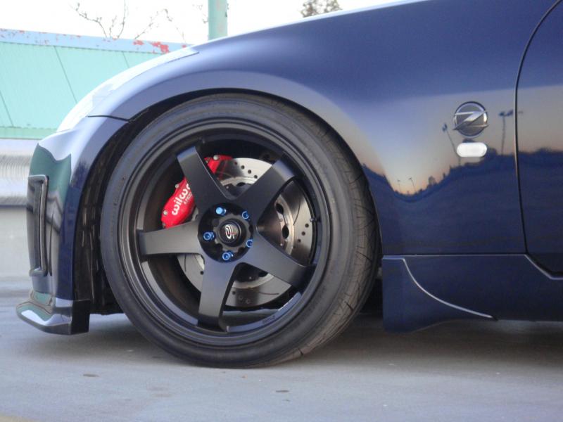

This is a simple mod. You just have to man up! Cutting into your car is nerve racking! I first did it on my WRX and now did it to my 350Z. You can buy everything you need right from Nissan. Pics of mine are in my album..

the original picture in the ops post is mine. I just eyeballed the distance from the Z logo to the top of the sidemarker by looking at pictures of Japanese Z's. As for the harness, I used ones off a jdm EF civic. The gray plug that holds the bulb is actually made of rubber, so it fits in real tight and snug into the lens. Even though the little tabs don't line up to the ones one the sidemarker, the rubber is very flexible and its goes in probably better then it would OEM wise. btw, if you plan on doing this yourself and you make an outline on your fender, always cut inside the lines you traced. If its too small you can always shave more off, but if its too big you're screwed.

A quick guide to doing this install.
1--have a drill--with Metal bits
2--A dremil tool
3--A nibbler--This tool you can buy at a Auto Store. It cut pieces of sheet metal in tiny little squares.
Make a stencil to outline the whole. Use pleny of blue tape to mark the area around where your going to cut. Why?? When that dremil slides, you will put a nasty gash in your paint. Outline the whole with the stencil. If you prep the stencil and measure you can get the distance from the badge to the sidemarker perfect.
Drill, cut with the nibbler, sand with the dremil--use a little silicone--mount
done
enjoy
