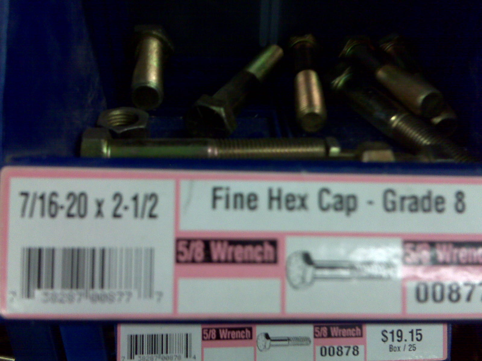

Originally Posted by USN HM 350Z
I bought new bolts for the seat belt to b pillar. 5mm longer than the stock. grade 8
Call me crazy John, but did those new bolts happen to be Standard sized 7/16bolts? I made a little trip to Home Depot during lunch and couldn't find any metric bolts or nuts that mocked up. However, I did find some 7/16 x 2 1/2 inch bolts that fit pretty damn good. The 7/16 nut also threaded on to my OEM bolt pretty snug. I believe it was a hair bit more snug on the Standard sized bolt though...

Ok, I woke up an hour early this morning so I could make it to a specialty hardware store that has the largest bolt selection in Houston. It's called Turner Hardware. One of the salesmen there helped me find what I needed. I bought an assortment of washers and a couple of hard nylon spacers also. You'll see what I need those for later, when I do the write-up. The bolts were the important thing to purchase. I purchased the Grade-8 bolts like John suggested. Just an FYI, Home Depot does not sell Grade-8 bolts. Theirs are Grade-5, the weaker ones.
I was right too. The bolts are 7/16. Don't ask me why Nissan decide to use Standard sized bolts instead of the traditional Metric sizes that imports use.
The new bolts are 2 1/2inch long. The OEM bolts are 2inch long. Heres a picture of the exact size needed...
