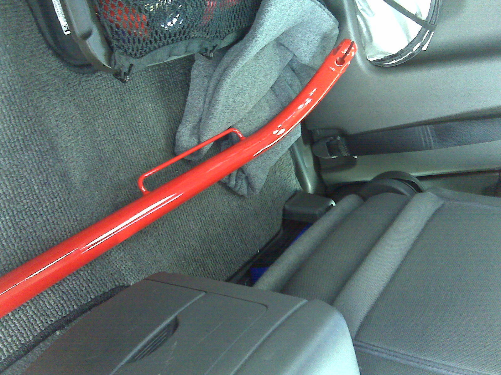

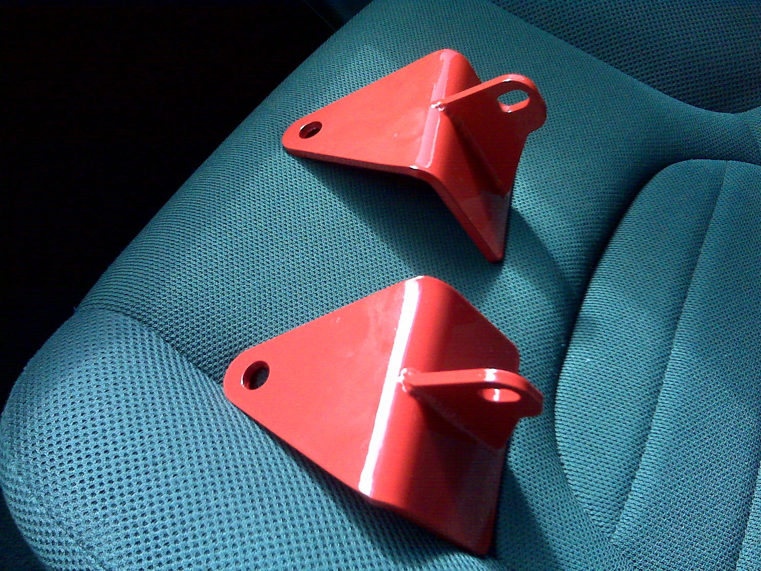

Picked up the parts during lunch. I'll start the installation process tonight...

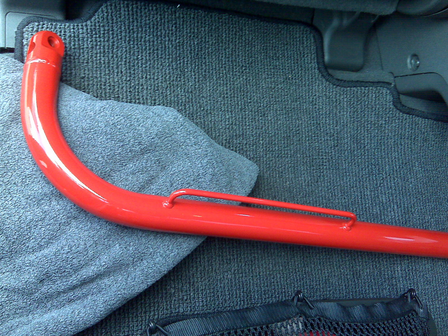

Here's one more picture of the bar...
Attached Thumbnails I'm Making a Sparco Harness Bar DIY. Anyone Have Installation Tips?-img00052.jpg

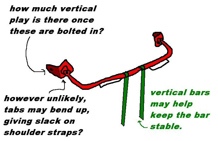

so the side brackets are the only thing preventing this bar from flipping forward or downward during a pull on the straps?
the vertical bars when attached to the ground, make sure that in the event of a severe frontal impact, the strain on the harness doesnt make the bar 'flip up' or 'flip down', thus giving slack on the shoulder harnesses to keep you in the seat...
edit: i think i flipped the side brackets backward in my drawing.. the part that attached to the B pillar i'm not afraid of. its those tabs welded to it... moment of pivot would be going up or down.. there is no top or bottom triangluar bracing preventing those little tabs of bending up
It is actually very very strong. The wa the side brackets are made, they will not fold up or down once installed.

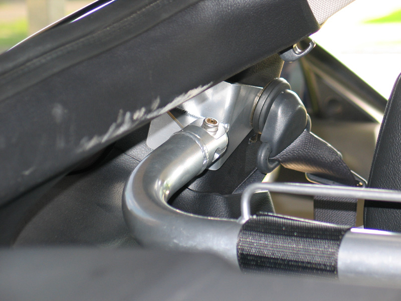

+1. Here's how the brackets sit. The bracket part that wraps around the back side of the B-pillar prevents the bar from twisting upward or downward.
I borrowed the attached pic from this thread:
https://my350z.com/forum/exterior-an...lled-pics.html
oh ok.. cool. just keepin' an eye out for you.. i just dont want to take over your OT mod responsibilities if something were to happen .. <3
