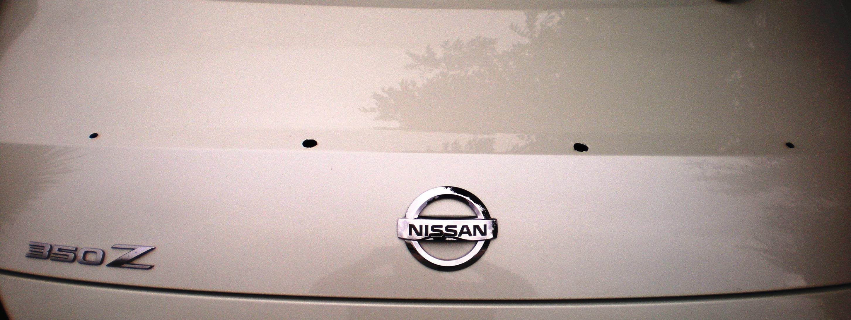

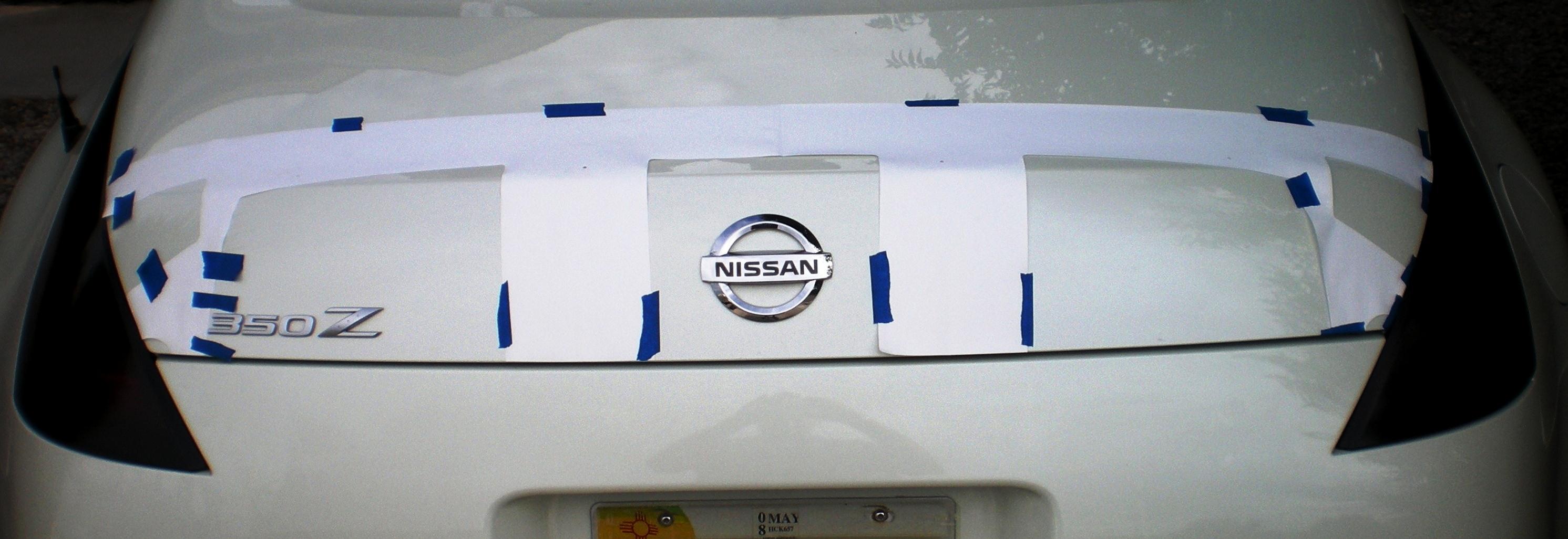

Mine has 4 screws on it when I put it on my Z car, plus 3M double sided tape.
Attached Thumbnails Remove Stock Spoiler?-back-end-0404.jpg   Remove Stock Spoiler?-full-template-0395.jpg

The stock spoiler has 4 bolts on it, like in the pics above.
Good luck
