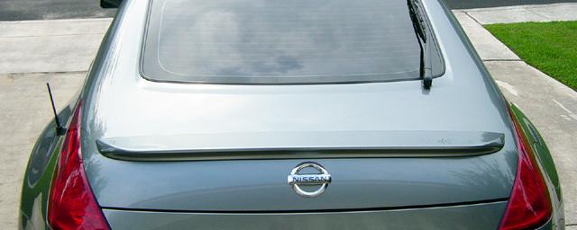

Mine.

And.

Looks nice! I was thinking of putting the Z emblem in place of the Nissan emblem and getting rid of the 350Z emblem as you have done. e.g. in this picture:
Has anyone done this?

That's what I did to mine. Looks nice.

I'm thinking about doing this as well. Do you just use a hairdryer to loosen up the badges? Are they difficult to remove?

minus the 350 Z looks very nice.... i think i have a wkd project!!!!
removing the badge was a PAIN IN the butt... be careful not to scratch the paint... practice first if you can Use heat gun!

Yes I just plugged in the hairdryer in the garage and heated the letters up. Then I used dental floss to get them off but you can probably pull them off if they are hot enough. Don't burn your fingers. Then I used the automotive goo gone from walmart or some other store to clean the area of glue. Then I claybar'd the area and waxed it. Later on I washed, clayed, and waxed the whole car and that is what it looks like now. Also, don't forget the hairdryer in the garage or you may suffer repercussions from the person who actually uses it upstairs.
