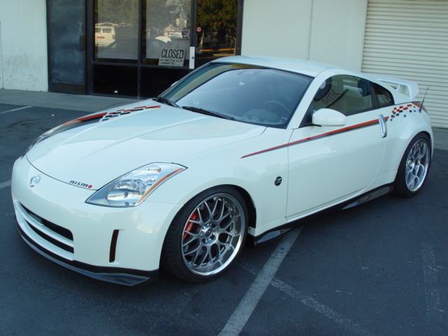

Attached Thumbnails NISMO Aero body kit arriving at JFK - Friday-nismo-cf-body-kit-019.jpg

Interesting, that you painted the side skirts, rear underspoiler (did you?)and bottom of front bumper black; does look pretty slick with the side and bonnet markers too.
Looks outstanding!
Looks outstanding!
Thanks
G
actually it's a carbon fiber nismo replica body kit
Attached Thumbnails NISMO Aero body kit arriving at JFK - Friday-nismo-cf-body-kit-013.jpg
I thought so; is the whole piece made of carbon fiber, or was it just the bottom lip? I was considering the carbon fiber kit initially, but since it was difficult to paint I went with the NISMO kit.
the whole piece was made of carbon fiber, not just the lip.
but on fitment, the replica carbon fiber kit fit was great, no modification (or very little) was needed.
a good bodyshop would always test fit a bodykit before paint, even if it is an authentic NISMO part.
