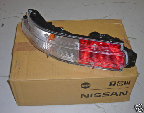

But you would also loose reverse lights.
Attached Thumbnails 350z euro fog lights installation-bifjmwqbmk-kgrhqyokiwesnp6wgbbblmq-mwcvw-_12.jpg

It replaces the driver side reverse light with a red fog light...it's the one used in the european z it's a rare part
As Guilty1s mentioned. Wire directly to the taillights.
