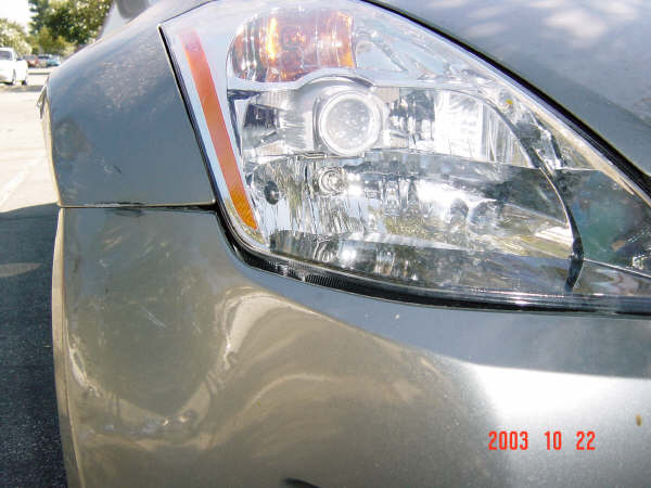

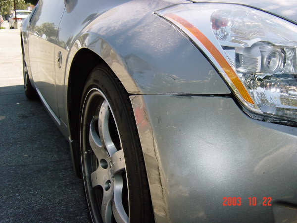

Hi~ just crush my front bumber and front fander, so think about get aftermaket body kit. please tell me what body you like

Hi Thank you guys to reply, I am thinking to get Amuse Front Bumper and Amuse Light Weight Wide Front Fenders. What do you think?

second

your bumper and fender can easily be fixed..if you are looking for an excuse to buy a kit then go ahead...but if you really just wanna fix it you can

Light weight fenders are a bad idea for the street IMO, if you had them in this accident the damage could be much more severe. Just put a stock fender back on there.
