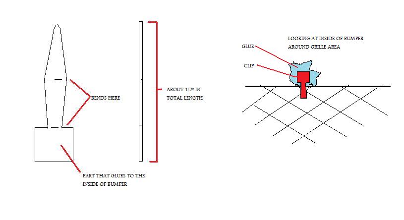

I am trying to figure out how to put the mesh on my V2 bumper. I have searched, but the only pics that I have found are from the front. If anybody knows or have pics of theirs I would really appreciate it. Thanks.

You have to speed grip little flat metal clips that bend to the very inside all around grille area, then place mesh on (while metal clips pointing out towards you) with clips all around going through some of the mesh holes, then bend metal clips upward away from grille opening and around the metal mesh holding it in place.
Thats how it was done on my V2.
I know that may make no sense whatsoever, and my Z is in the shop getting kit repainted and FRP driving damage repaired, so no dice on pics for another 9 days.

What do the clips look like?
I was trying to find a pic for you, but dont know what they are called so i cant
Alright i will draw for you in mspaint.....damnit. brb.

oK, here is what it roughly looks like...

Thanks. So use epoxy and those tabs. What tabs are they?
They came installed on my V2. They are some kind of flexible metal.
