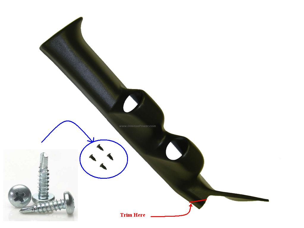

so it says it can be modfied to fit 60mm gauges. do they do it.. or do i modify them once i recieve the product?
i wanted to put 2 60mm defi boost and oil temp gauges.. and one 52mm aem wideband.

its just that they have a "lip" that you can get a dremel sanding stone to cut away at and make 60mm gauges fit in the hole.
no biggy....
-J

Also, take note that this is not an A pillar replacement? it goes over your current oem A-pillar and you will have to drill holes into your oem a-pillar in order to route wires through it.
Also, i found that the very bottom corner, i had to trim with my dremel to get the correct fit. once trimmed correctly you cant tell it was trimmed unless you hack off too much..
I didnt use those plastic plugs the come with....the bite........i used short self tapping sheet metal screws to install mine.
-J
-J
When I had it done it was a direct replacement. Wiring was routed behind the pillar.
I had to trim with my dremel to get the correct fit.
If installed correctly this is not necessary.

In order to fit the 60mm gauges you will have to trim the opening. I used a Dremel with a grityy sandpaper drum. You take the Dremel and work the outer edge expanding it slowly. You will need to offset the opening slightly toward the "meaty" end (toward the pillar). Just take time and constantly test fit the gauge until it fits. Do not make the opening too large as the gauge will be held in place by the tight fit.
PM me if you have more questions.
