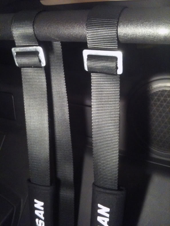

Originally Posted by JasonZ-YA
that looks close.........but i cant be certain cause i cant see the end??? where is the end of the strap......and get the clip with the eyebolt to the end..and ill show you where.
-J
I couldn't fit the end of the strap through
again it is too thick.

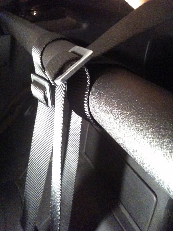

Okay, it apprears as if you almost have it right.......see, on post #3 if you look, the end of the harness strap will allow for the mount to come completely off........thats what you need........
now of course you can choose to leave the mount dangling there........let me search through a bunch of threads and see if i can find you a picture...
if not, ill take a picture of my own on my car......i had to cut the very LAST inch in order to let the mount slip off and toss it aside..
-J

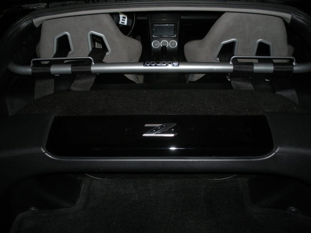

This is how I mounted mine, using a Sparco backing plate mounted in the transmission tunnel and the stock lower seat belt location.
*edit* Here is the Sparco reinforcement plate. http://www.sparcousa.com/pharness_comp.asp?id=479

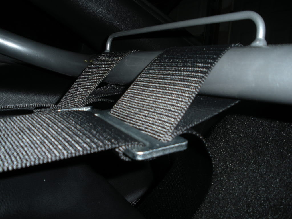

VO, check out this pic to see how I inverted my setup to avoid having to trim off any excess straps.
https://my350z.com/forum/7998016-post20.html

So in inverting the buckles, I'm assuming the portion of the shoulder harness that goes across your chest is also inverted? In my case, this would put the Takata logo backwards. No bueno...
Attached Thumbnails Takata bolt on harness question???-harness1.jpg   Takata bolt on harness question???-harness2.jpg
yes! thats correct! but just inverted.......no biggy im sure..

This is my car - I backed it off the harness bar to show the loops and the top right corner shows my cut END:
-J
